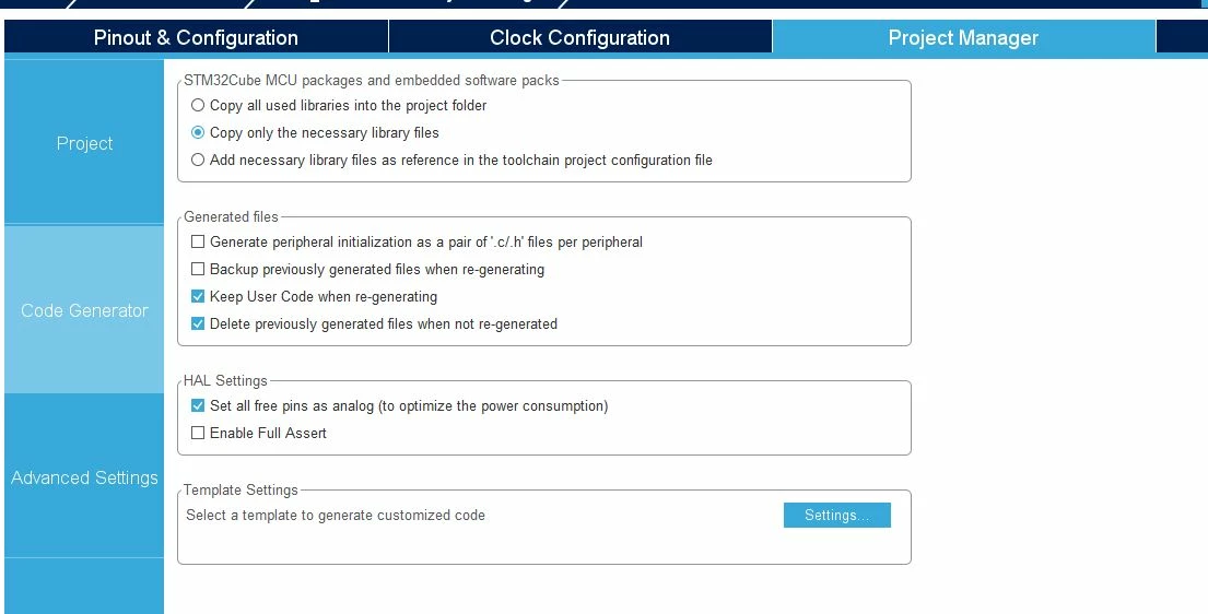

You should add the functions in the User Code section:
/* USER CODE BEGIN 0 */
/* USER CODE END 0 */
Ensure that following option is checked : "Keep User Code when re-generating". In this case, the user sections defined by STM32CubeMX are preserved.

You should set the Backup previously generated files when re-generating option :
  • Backup previously generated files in a backup directory: The .bak extension is added to previously generated .c/.h files.
  • enabled in the Code Generator tab the following option : "Keep User Code when re-generating" in the Project Manager view > Code Generator tab. User Code is kept during generation the C code, when this option is enabled. It's applies only to user sections within STM32CubeMX generated files. It does not apply to the user files that might have been added manually or generated via ftl templates.
