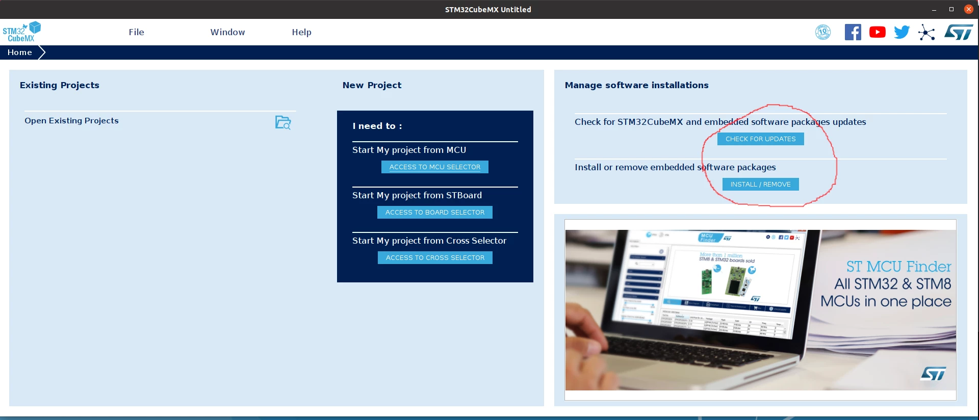

I installed STM32CubeMX 5.6.1. When I ran CubeMX it freezes when I click Install/Remove embedded software packages. How can I fix that?

There is a section for managing software installation. When I click any button here ("CHECK FOR UPDATES" or "INSTALL / REMOVE") the CubeMX freezes completely

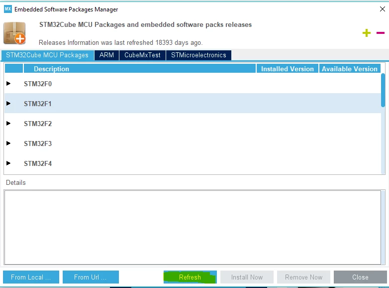

Try to check your Network connection.
Then click on Refresh before Install embedded software packages.

Hello, I was solved the issue, I switched from openjdk 8 to oraclejdk 14 and problem solved. By the way I'm using Ubuntu 20.04
