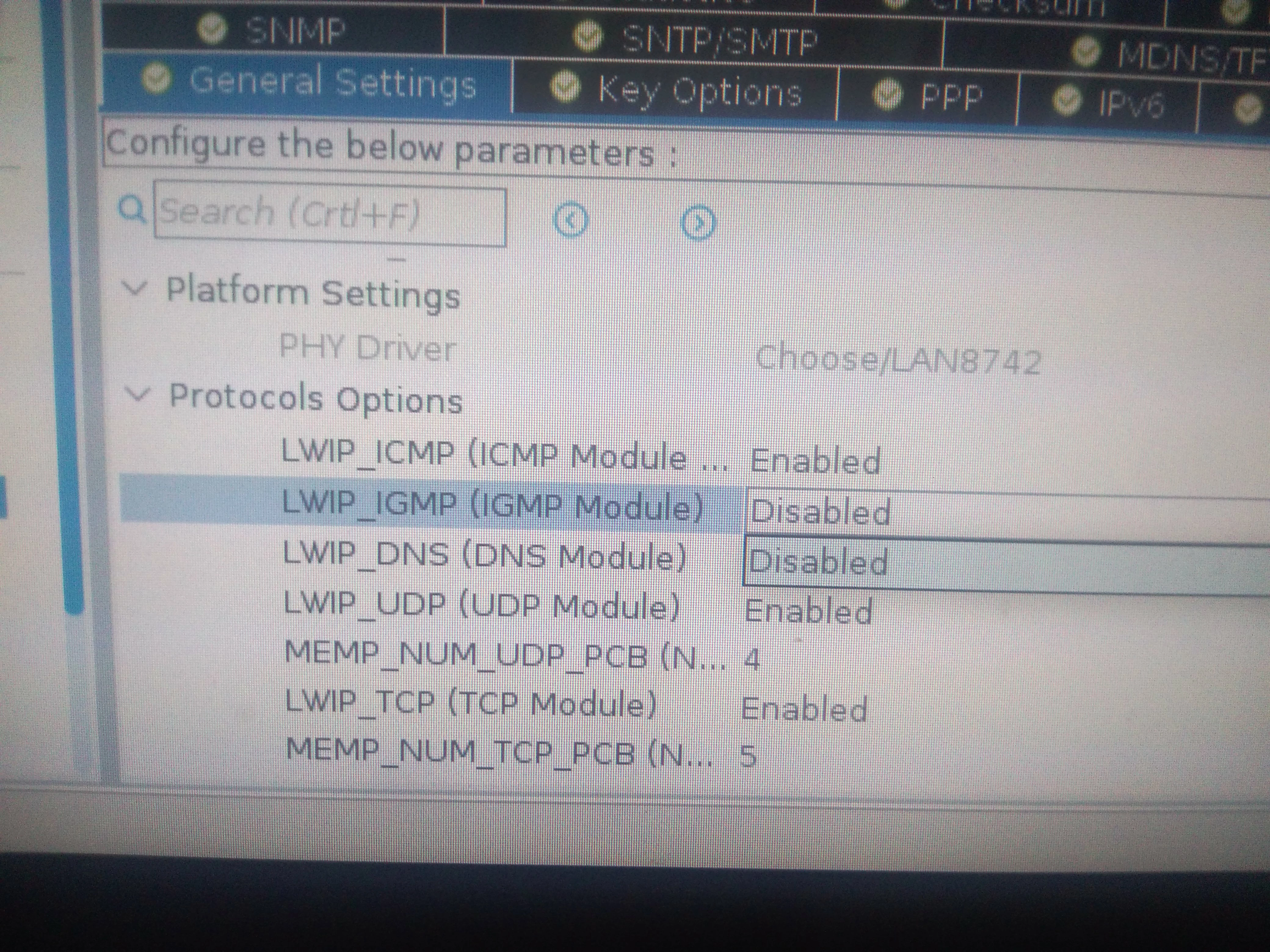

I have using STM32h753zi based MCU and i am trying to enable IGMP but i am not able to enable the IGMP module. Please give me the guidance. Thankyou.
  • September 8, 2020
  • 970 views
I have already enabled the LWIP but IGMP not able to enable.

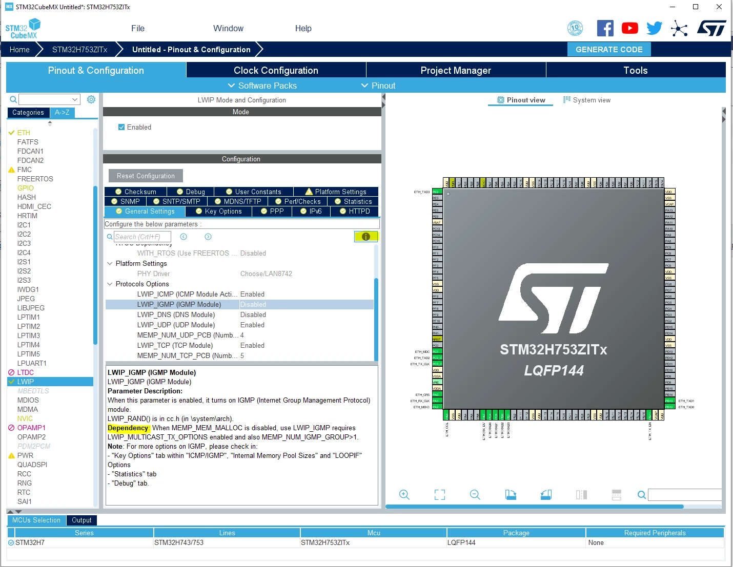

Best answer by Khouloud OTHMAN
Hello AFaya.1,
Please check the LWIP_IGMP description, you will find the IGMP module dependencies to be able to enable it.
Regards,
Khouloud.
2 replies
Khouloud OTHMAN
Khouloud OTHMANBest answer
September 8, 2020
Hello AFaya.1,
Regards,
Khouloud.
