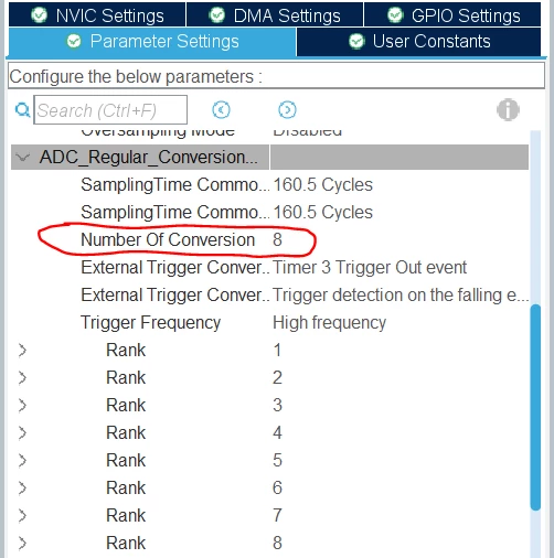

I have to use 9 ADC channels using scan conversion mode. I can't set Number Of Conversion field more than 8. The ADC used pins are set as ADC inputs. If somebody has an answer please help me with this thing. Thanks in advanced.

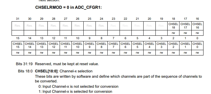

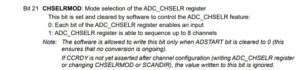

from
set
0693W00000bhOlFQAU.pngbut you want > 8 ch , so :
0693W00000bhOleQAE.pngok ?

yes, sorry for that. It's about STM32G0B1RET6

clear
thanks for your support
