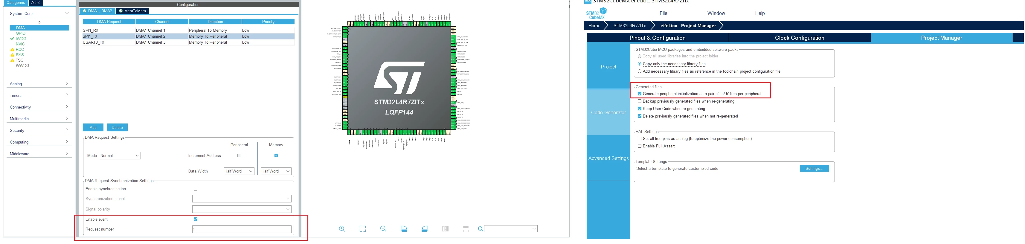

By disabling all SPI, code generating and very slowly adding SPI features again, I was able to generate code again with CubeMX 6.2 / CubeIDE1.6.0 SW package 1.17
The only difference I found is this DMA configuration line in the old settings which is now gone in the new settings.
Maybe this line caused the migration problem.
I don't use DMAMux. This line was enabled by CubeMX when DMA have been added.

Backing to your project, you're using "Enable event" for the "SPI1_TX" DMA request as well as the "Generate peripheral initialization as a pair of .c/.h files per peripheral" option:
When using "Enable event" for the DMA Requests when "Generate peripheral initialization as a pair of .c/.h files per peripheral" option is enabled, STM32CubeMX will generate code with this exception.
This misbehavior is reported internally to be reviewed. I'll surely keep you posted with the updates.
Thus, what I can propose in this case is whether to not to use the "Enable event" or uncheck "Generate peripheral initialization as a pair of .c/.h files per peripheral" option, normally your project will be correctly generated.
