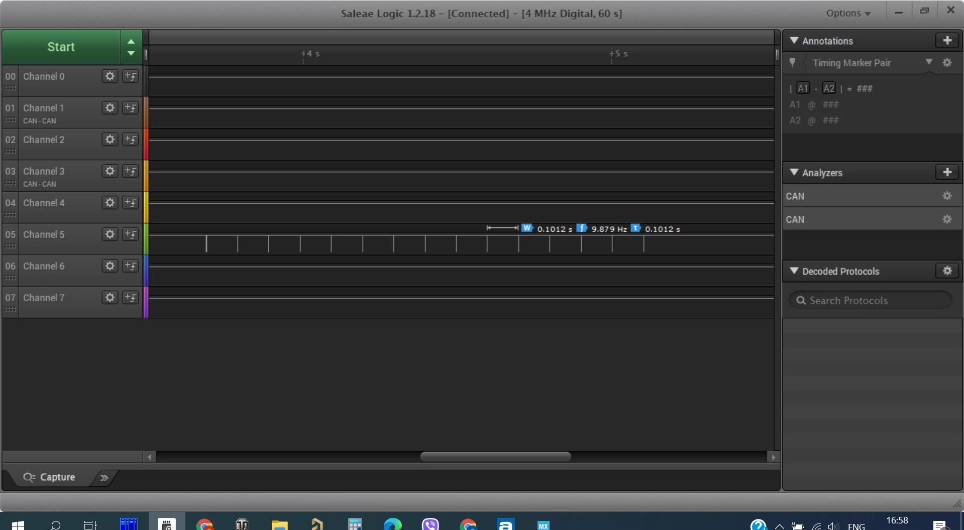

I can’t start the CAN module on STM32F103C8 in normal mode
when I run the CAN module in loopback mode - packets
 transferred to the bus - everything is OK
when I run the CAN module in silent mode I will receive packets - everything is OK
but when I start the CAN module in normal mode - 15 pulses go out on the TX pin and everything stops ... packets are not transmitted ...
what am I doing wrong???
I generated the start configuration using:
STM32CubeMX 5.6.1
Firmwere STM32Cube FW_F1 V1.8.0
Atollic TrueSTUDIO Version: 9.3.0 Build id: 20190212-0734
I've been in conjunction with both ISO1050 and MCP2551 ...
I looked at the bus using a Chinese logic analyzer ....
connected to the parallel of RX and TX pins

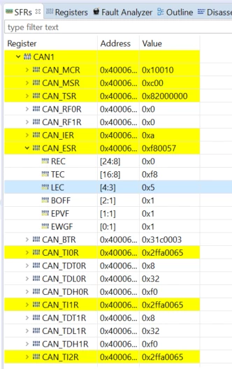

found what was the problem ... my mistake with the power supply of the can transceivers (MCP2551 needs 5V, ISO1050 needs power from both sides)
since all that comes to the input of TX CAN tansiver is immediately "exits" from the output of the RX CAN transceiver, then when the microcontroller sends a Packet to the TX channel, he expects to see this parcel at the RX input .... if it does not see this packet (the first bit of the packet) it immediately interrupts the transmission and sets the "Bit dominant Error" flag, which is not described in any way in the Reference manual on STM32f103

Check the CAN status registers to determine why TX stopped. You may have a problem with bit timing.
Does the HAL routine check for an available TX mailbox? I don't use HAL or LL drivers.

in CAN_ESR register the error "Bit dominant Error"
I did not find the description of this error in a datas ...
CAN_ESR 0xf80057
REC 0x0
TEC 0xF8
LEC 0x5
BOFF 0x1
EPVF 0x1
EWGF 0x1
the drawdowns that I observed (screenshot in the first post) are attempts to send messages ... it's clearly visible if you run the commands step by step in the debugger mode ... if you run the program on a looped execution then an error occurs sending messages in all buffers ... which causes the transmitter to stop .... it is not clear why, instead of normal messages, only one pulse passes ...
there is an assumption that due to the fact that the transceiver is on a separate board and connects to the microcontroller via wires, the synchronization process with ... the receiver ?? .... failed ... maybe there is a problem in the length of the wires between the receiver and the MCU (approximately 2000 mm)....
