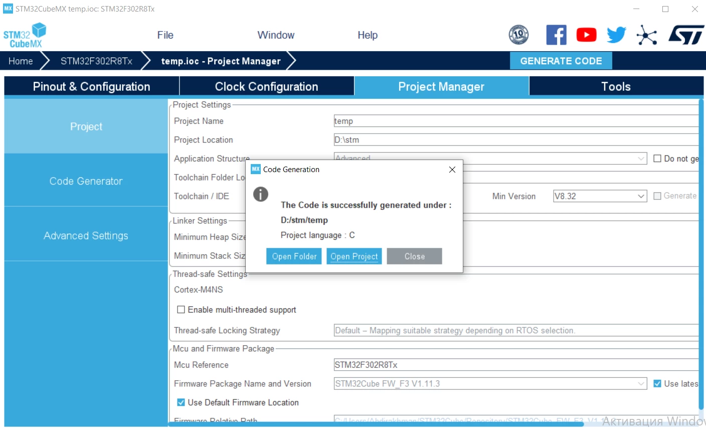

I can't open the .project file after a click "generate code" in .ioc file. "not a valid ioc file" pops up. What might be the issue?

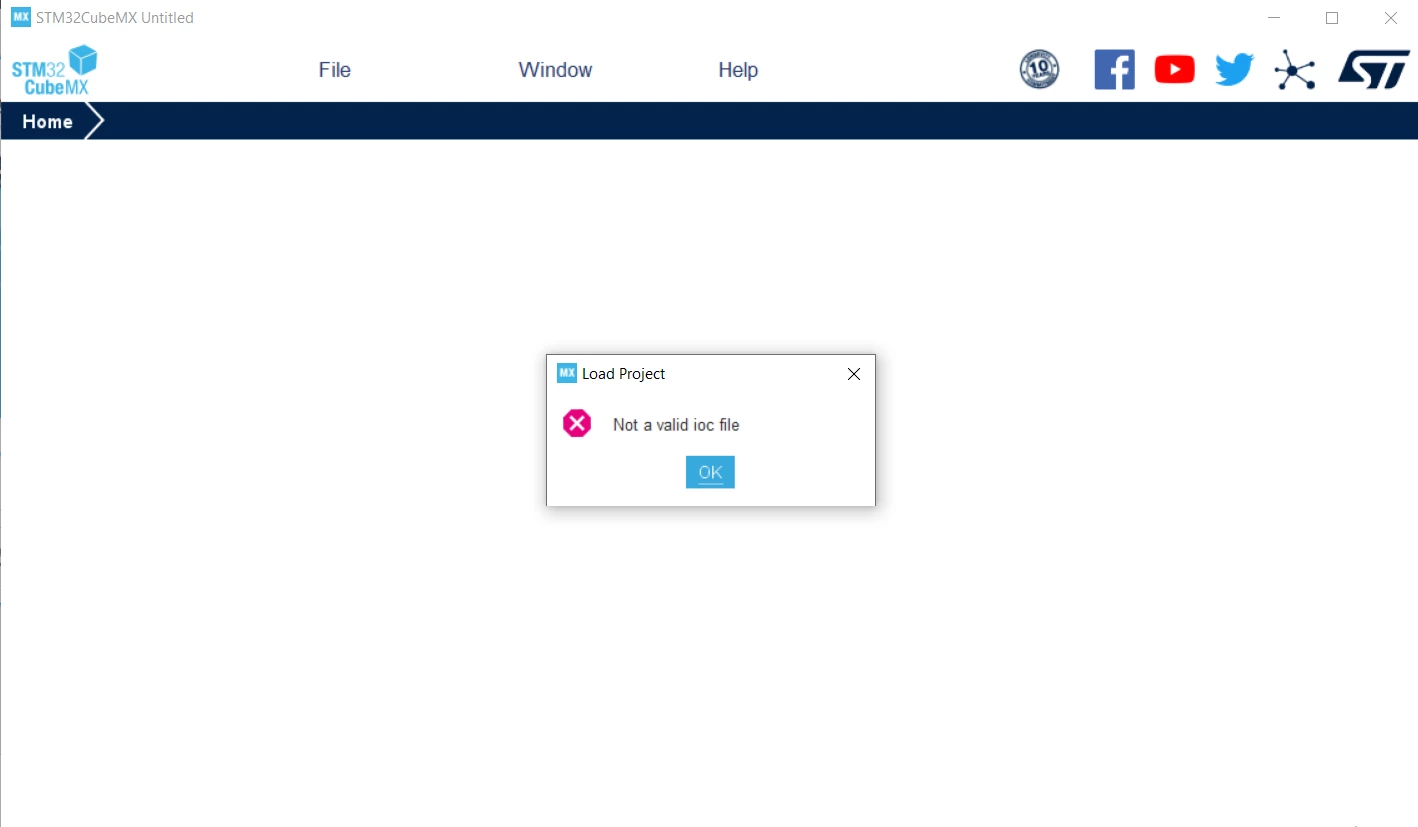

In the STM32CubeMX I click "File -> New project", choose the board(STM32F302R8). Then I click generate code, enter the project path and project name, and click generate code again. After the code is generated, the following window pops up.0693W00000NppcFQAR.pngI click "Open Project", and the following image pops up with the error "Not a valid ioc file."
0693W00000NppdNQAR.pngPlease find the project folder attached below.

Please try to open the temp.ioc via File... Open dialog.
Do not open the .project file with CubeMX, it is an Eclipse (CubeIDE) project.

I've realized that was a dumb question... I opened the project with CubeIDE. Thanks a lot!
