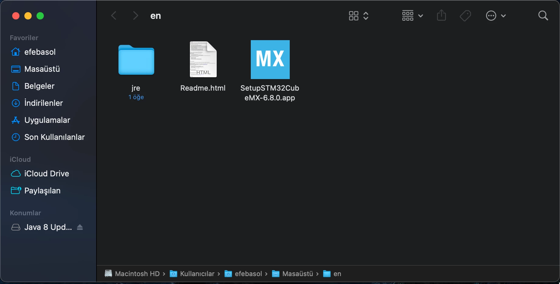

I can't install STM32CubeMX on Mac with M2 core
  • March 20, 2023
  • 4 replies
  • 2983 views
0693W00000aJLmcQAG.pngWhen I try to install the application, it opens and closes and does not give any errors. I read the readme.html file but the ones there did not work. Can you give some information about how I should install it?
4 replies
RBamf.1
March 22, 2023
Hi, try to launch the app using the command line, perhaps by running "./SetupSTM32CubeMX-6.8.0.app" in that directory? It might provide some debugging information.
February 9, 2024
By running from the command line, you are not getting the option to override the "unsigned software" error dialog
February 9, 2024
You need to
a) Install Java. There was a "java" already on the system, but the installer complains that it doesn't find a JRE. I took Java 8 JRE.
b) Try to start the STM installer twice. The second time, it will allow you to override. Still, nothing will happen.
c) Now, under System settings / Gatekeeper, there should be "java" mentioned as having been blocked (because it came from the Internets too). Allow it.
d) Now, when you try to start the installer a third time, it should work.
