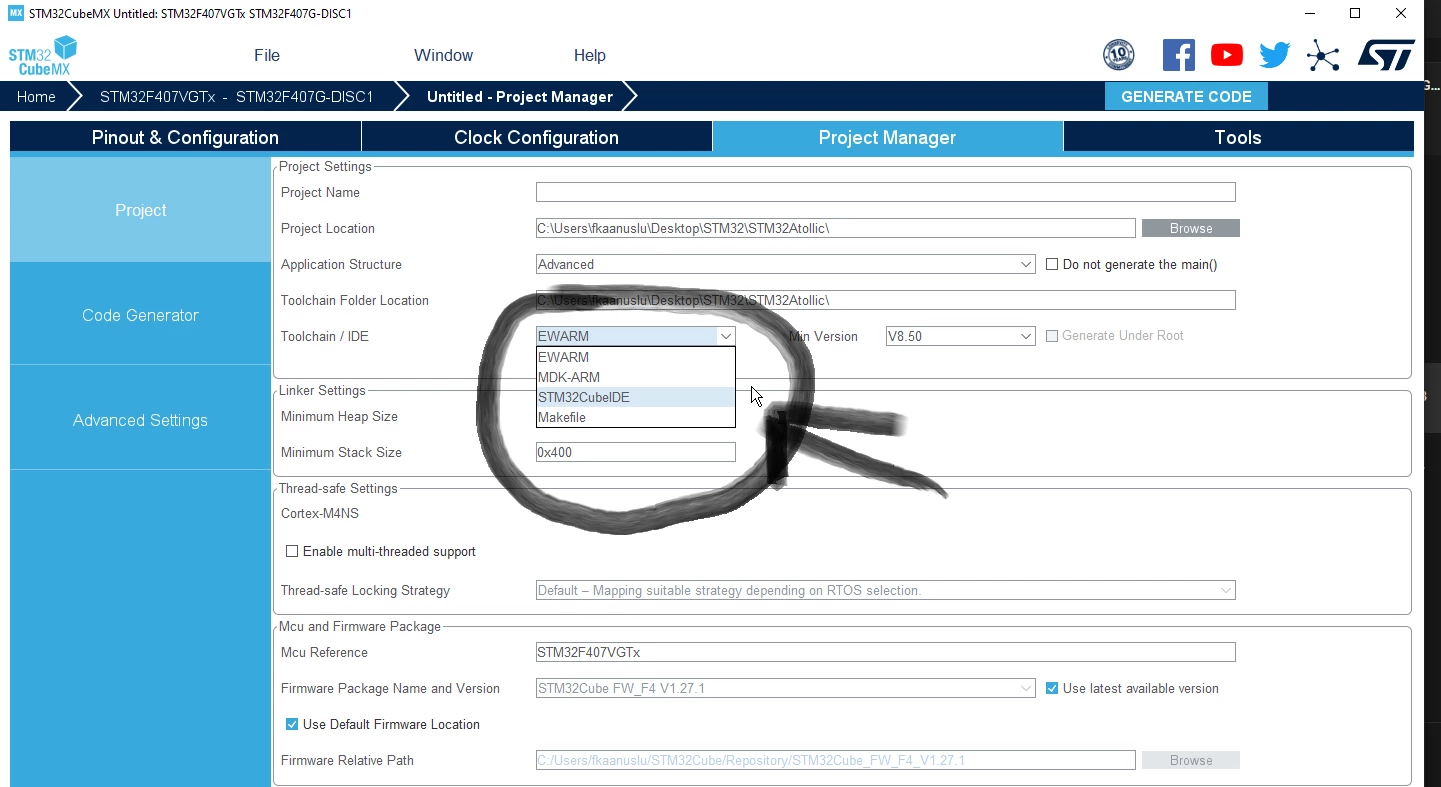

Hello @kuslu.1​ and welcome to the Community :)
Since STM32CubeMX 6.6.0 released: TrueSTUDIO, System Workbench for STM32 (SW4STM32), and the GPDSC option are removed from the list of supported IDEs in STM32CubeMX.
It's recommended to use STM32CubeIDE (an all-in-one multi-OS development tool).

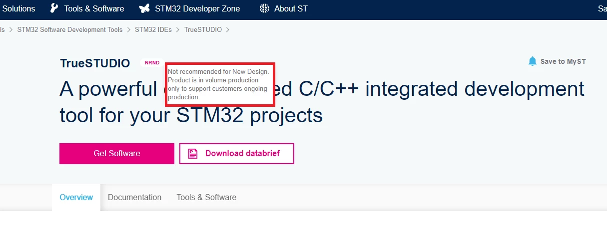

Note that TrueSTUDIO is not recommended for New Designs (NRND).

gbm
August 2, 2022
CubeIDE, which includes CubeMX as a component, is the former TrueStudio. Why don't you use CubeIDE?

ToasterOvenDan
May 15, 2023
Great. Now ya tell me. After I spent 1/2 hour downloading the lastest version. I could've got version 5 that works with Atollic.
