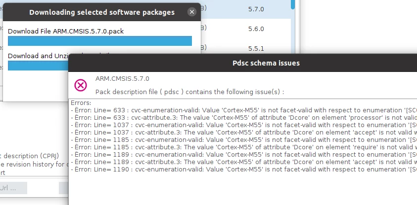

Adam Hamilton
Senior
May 17, 2020
0693W000001cNwmQAE.pngHi @Khouloud ZEMMELI​. There is still an issue
This is the build information I have
STM32CubeIDE
Version: 1.3.0
Build: 5720_20200220_1053 (UTC)
OS: Linux, v.5.4.0-29-generic, x86_64 / gtk 3.24.18, WebKit 2.28.2
Java version: 1.8.0_242
I have attached an image of the error.
When can we expect this to be fixed?

Adam Hamilton
Senior
July 19, 2020
Before you close the dialog box, you will find the pack file in the <repo directory>/Packs/ARM/CMSIS/5.7
Unzip the file so you have the following files residing in the same location as the .pack file
  • CMSIS folder
  • Device folder
  • ARM.CMSIS.pdsc
  • LICENSE.txt
This should work. I only just tried this myself and it appears to work.
For the ST Employee: Why is this issue still hanging around 6 months later? Why is this considered an error - maybe this should just be a warning, or silently ignored as you don't have any M55 based cores in the STM32 lineup, which is probably why it doesn't exists in your schema.
Does ARM have a schema that you could use for validation?

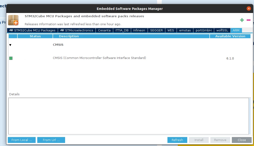

Visitor II
September 22, 2024
Okay, this is a BUG with StmCubeMX.. and it has NOT been solved in over 18 months since the release of 6.2.0. I use linux, and here is how to solve it:
1. Download the CMSIS (for ARM) pack: https://www.keil.arm.com/packs/?q=&pack-search=&vendor=arm&sort_by=. For me it was "ARM.CMSIS.6.1.0.pack".
2. Extract (unzip) this pack and open the "ARM.CMSIS.pdsc" file in text editor, an XML file. Make sure you can see the line numbers.
2. In your Stm32CubeMX, Embedded Software Packages Manager: You would see the ARM tab missing. Click "From Local.." button. And load the "ARM.CMSIS.6.1.0.pack". It will throw errors.
3. Now, for each of the 4-5 errors, do the following:
- Comment out the Cortex M-52 line <~-- content -->
- Remove the <licenseSets> group in the first few lines
- Remote the link from description, so it looks like below,
<description>CMSIS (Common Microcontroller Software Interface Standard)</description>
4. Now, after editing save the file.
5. Compress the 4 files (that were originally inside the .pack with the modified .pdsc) as zip. Name it something, e.g. "ARM.CMSIS.6.1.0_custom.pack" (rename .zip to .pack).
6. Load this pack, it will WORK! and will show the ARM tab.
This is the problem with closed source. We cannot see what fixes they made, and they cannot see our pain!
Good luck!
