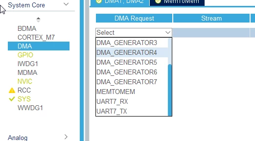

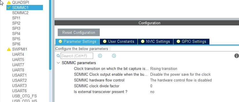

I can't add DMA to SDMMC
Hello!
I have last version of CubeMX
I try to add DMA to SDMMC1
but I can't see "DMA" option sheet. How can I add DMA?

Khouloud ZEMMELIBest answer
Sep 29, 2020 10:56 AM UTC
Hello @EEuge​ ,
It's not an issue, H7 using an Internal DMA (IDMA) contrary to F7, you can refer to RM for more details.
Best Regards,
Khouloud

Sep 6, 2020 6:27 PM UTC
And I can't see "SDMMC1" in listbox in DMA option page
Sep 6, 2020 7:00 PM UTC
Important!
This error is only for STF32H743 chip
For example, F746 chip - I can add DMA for SDMMC1 without any problem
