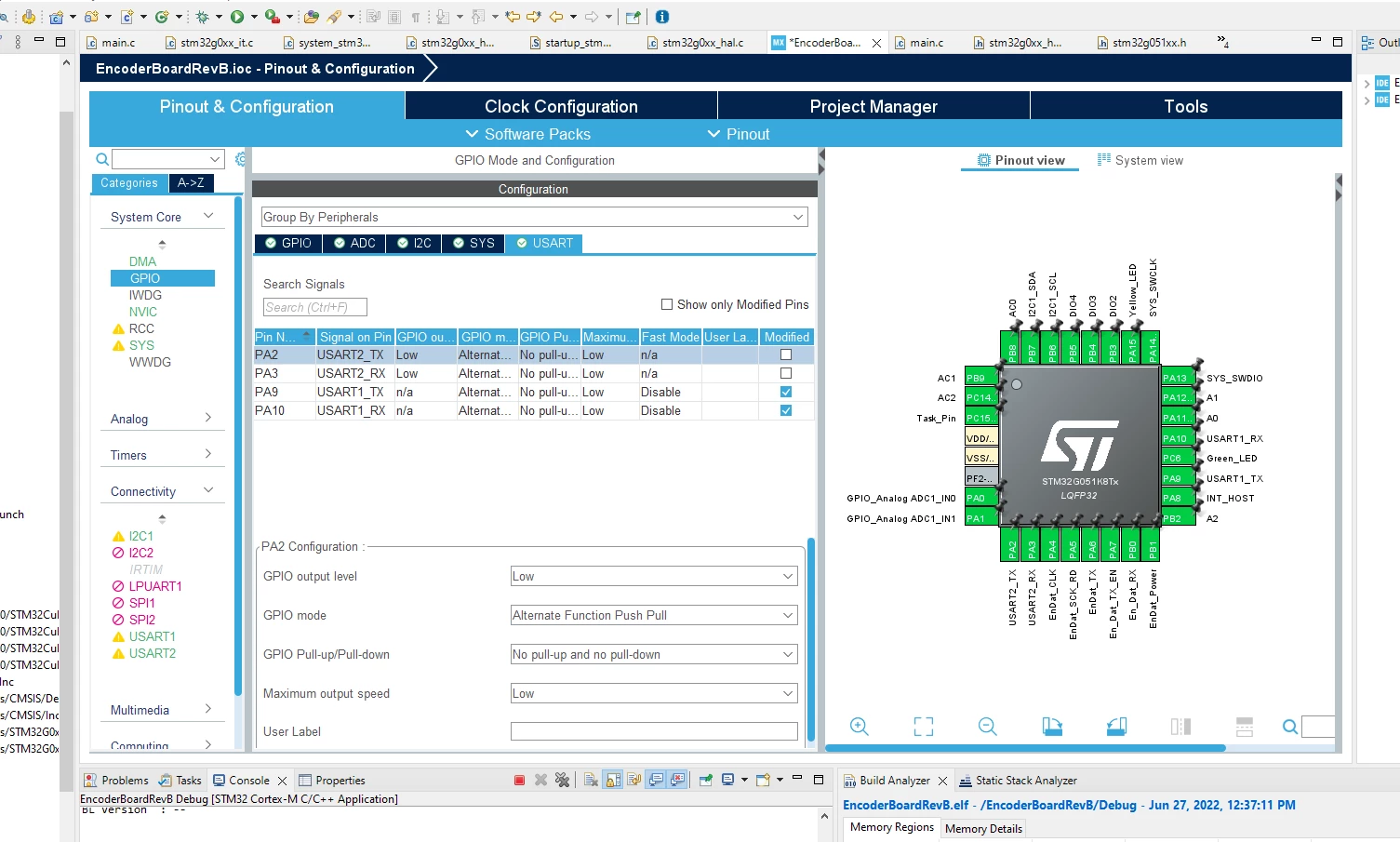

First the GUI is all screwed up.
When I look at USART2 It gives me the choices for
GPIO output level,
GPIO mode,
GPIO Pull-up/Pull-down
Maximum output speed
User Label,
it is missing Fast Mode.

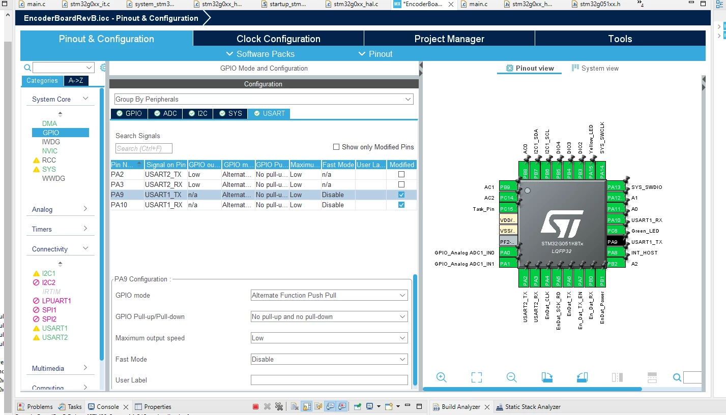

0693W00000NsptCQAR.pngI click down to USART1_TX and the list is different. It has
GPIO mode,
Maximum output speed,
Fast Mode
User Label
This one is missing GPIO Output Level.
And it says it is "Modified" I told it to revert to the default and it is still "Modified"
This is a known problem, but it does not help me that it is known.

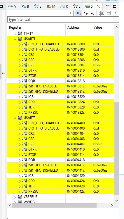

Well this is curious. I just looked at the registers for both USART1 and USART2 and they are identical!
0693W00000Nsq61QAB.pngSo it is not the setup of the USART1 or USART2 that one works and the other does not.
It must be the GPIO for the two TX pins.

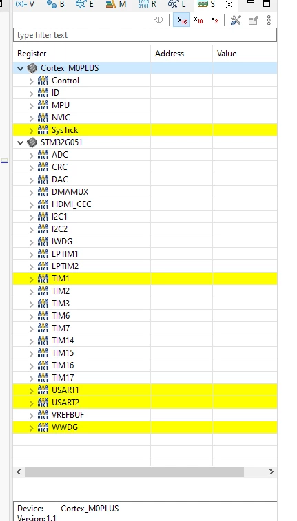

0693W00000Nsq6uQAB.pngWhy can't I see the GPIO registers in the debugger?
Am I missing them?

I opened up another bug report for the GPIO Registers.
The STM32CubeIDE has a debugger window that lets you look at the SPF (Special Function Registers). Why are the set of GPIO registers not included. I am trying to see if RA2 and RA9 are set up the same. But I do not know how to look at them in the debugger
But I found the issue that I was trying to solve here.
The MX program correctly set USART2_TX to alternate function AF1 but left USART1_TX as alternate function AF0 when it should have been AF1 also. That was why I was trying to look at the GPIO registers. Yet another MX program bug...
That only took 8 hours to track down.
