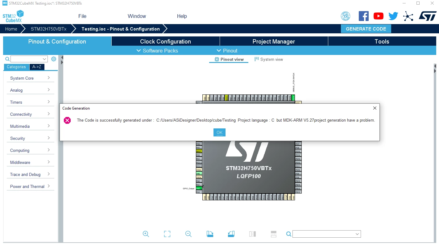

I can not generate Keil projects using CubeMX
I can not generate a simple project for Keil any more, The problem happened after I have upgraded my CubeMX from version 6.0 to 6.1.1
How should I solve the problem? what's going on wrong?0693W000007Z1CBQA0.png

Hello @ali_dehbidi​
This issue is normally linked to the java version used.
In fact, the minimum JRE version supported by cubeMX is 1.8_45, same for the version 11. For versions 7, 9, 10, 12 and upper, they are not supported and therefore a similar issue appears.
If you still face the same problem even when the java version used is supported, so there was a problem which happened during the Cube upgrade, in this case, please uninstall and re-install the CubeMX from site, and the problem will be fixed.
Hope my answer helped you, I'll be waiting for your feedback :) .
Thanks, Khouloud

ali_dehbidi
Feb 22, 2021 8:27 AM UTC
Hi Khouloud
Thanks for the feedback, I have uninstalled and reinstalled the CUBE same problem, would you please send me the exact JAVA version that's supported, so I can test to see if it would be ok, I'm using windows 10.
Best Regards
Khouloud ZEMMELI
Feb 22, 2021 12:40 PM UTC
Hi @ali_dehbidi​
All versions mentioned as supported in my last comment are supported by CubeMX, for my case, I'm using the 1.8.0_265 version (as an example).
If you still face a problem, please share your log file after facing the issue (log under C:\Users\..\.stm32cubemx).
Thanks, Khouloud
ali_dehbidi
Feb 23, 2021 8:03 AM UTC
Thanks Khouloud, the problem is solved. It was the java version.
