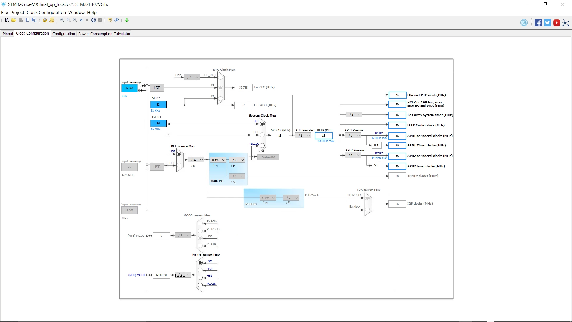

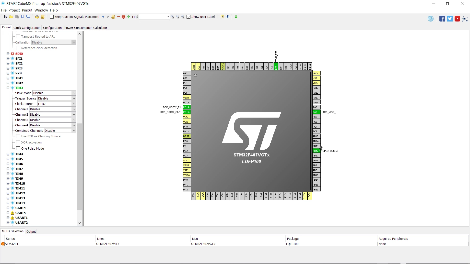

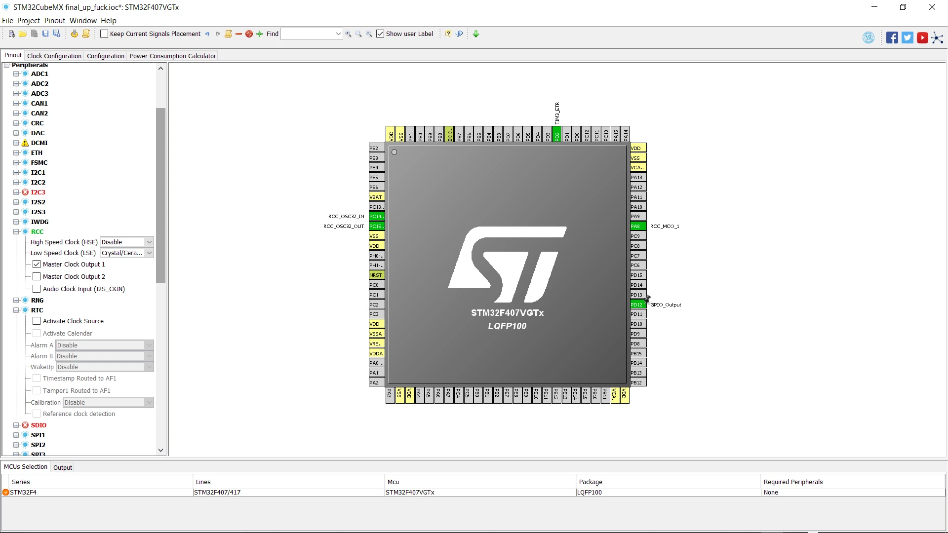

I am working with STM32F407VGt6-DISC1, I am facing a problem in getting LSE clock frequency out of MCO1 pin, and also other external source of clock whereas the same process for internal clock measurement through i worked fined.
  • February 17, 2020
  • 1 reply
  • 1012 views
Here i attached my main.c file.
and
When I run my debugger , i see that my program is stucked in error handler
_Error_Handler(__FILE__, __LINE__);
And for measuring internal clock sources such as HSI, HSE. it worked fine but whenever i include LSE source :it stuck in error_handler
RCC_OscInitStruct.OscillatorType = RCC_OSCILLATORTYPE_HSI|RCC_OSCILLATORTYPE_HSE
|RCC_OSCILLATORTYPE_LSE;
1 reply
waclawek.jan
February 17, 2020
The 32.768kHz crystal is not mounted on the F4-DISCO by default, did you get one? You need also to add the related capacitors and disconnect/connect some solder bridges according to the DISCO's User Manual.
