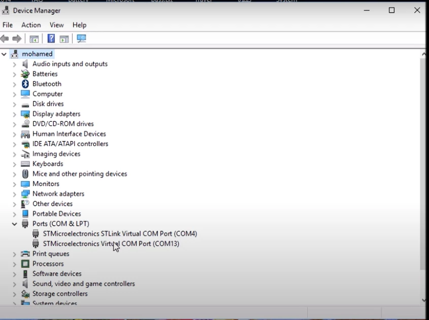

The main question:
I have an STLink Vurtual COM port displayed, that is, a virtual COM port from the USB MINI side.
the question is: I understand correctly that the same Vurtual COM port should be displayed on the USB micro side and then there should be 2 virtual ports? but my second one is not displayed.
I am enclosing an example.
I found a video that displayed 2 virtual ports, but 2 are not displayed for me.
https://www.youtube.com/watch?v=7oED-m34EKk

No, the virtual COM port is currently only routed via the debugger USB port, i.e. the one with Mini USB connector. In fact it is one of the physical UARTs of the STM32L476 connected to the STM32 acting as debugger.
You will need to insert a USB CDC to emulate a VCP directly from the target (STM32L476) if you need a 2nd virtual COM port via its USB port. This is what the guy in the video did.
