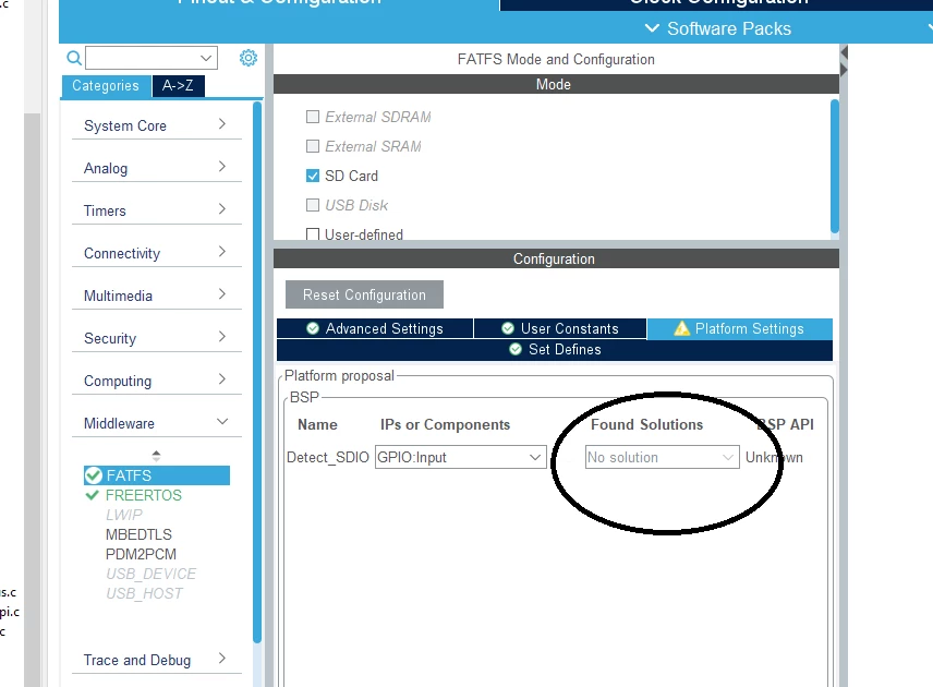

I am trying to find a way to load a driver into stm32cubeide version 1.10.0. I am trying to load the drivers for the fat file system. I have examples of code but are unable to load drivers in the the IDE.
I have examples but they do not use the .ioc file. I need to find a way to integrate the drivers using the ioc file.

Assume ST staff and forum participants have no information on the STM32 family you're using, the board, the pin level connectivity of your SDIO/SDMMC card. A lot of us aren't using CubeIDE/MX to auto-gen our code..
Perhaps you need to flag up a GPIO first, and THEN associate it with the FATFS/SDIO side of the configuration.
