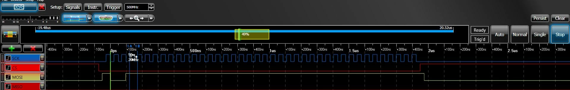

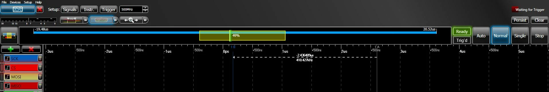

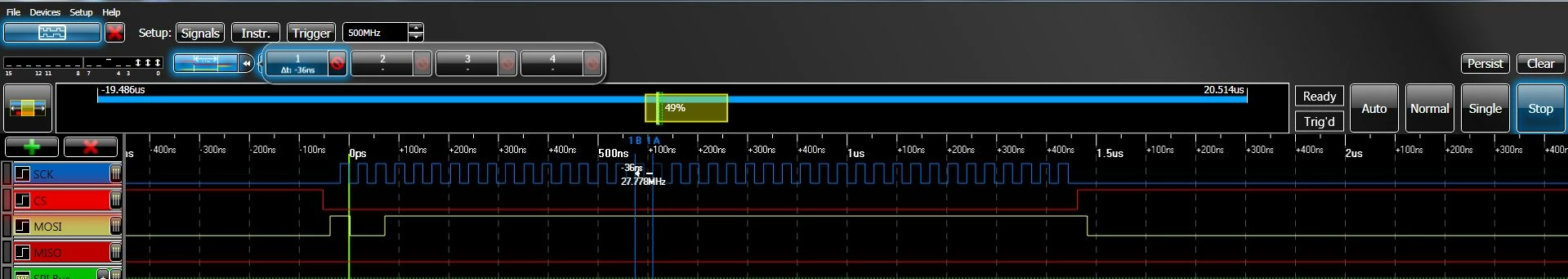

Here are some more inputs:
Nucleo H743 isrunning at 480MHz. Am using LogicStudio16 (500MHz) to analyze QSPI signals.
Am able to see QSPI CLK/ send data when QSPI prescalar is greater than or equal to 8.
My requirement is to communicate with flash IC at more than 100MHz (QSPI). So I need help to resolve the issue.
Screenshots were taken when flash IC PCB is not connected to nucleo stm32 H743.
When clock prescalar is 11:

QSPI pins gpio OSPEEDR register should be "very high"? Can't tell what's the value from the code. Compensation cells enabled?
So you do run "qspi kernel clock" directly from PLL? What "prescaler" are you talking about? The one from QSPI CR register?
Maybe look at your device Datasheet "6.3.18 Quad-SPI interface characteristics"
My guess is you cannot throw 480 MHz at "qspi kernel clock" but max 100/130 MHz and then have it prescaled or not.
Sk.2
Sk.2Author
Jan 21, 2020 9:39 AM UTC
Am running H743 clock from PLL (=480MHz). So max QSPI clock available is 240/((prescalar=1)+1)=120MHz
QSPI kernel clock source is default, 00=rcc_hclk3 in QSPI CR register. I have also tried with PLL1_Q_CLK source.
Previously i mentioned about qspi prescalars (one from QSPI CR register)
Currently I have tried with "medium" and "low" values for QSPI pins gpio OSPEEDR register. Will try with "very high" and update. - SOLVED.
