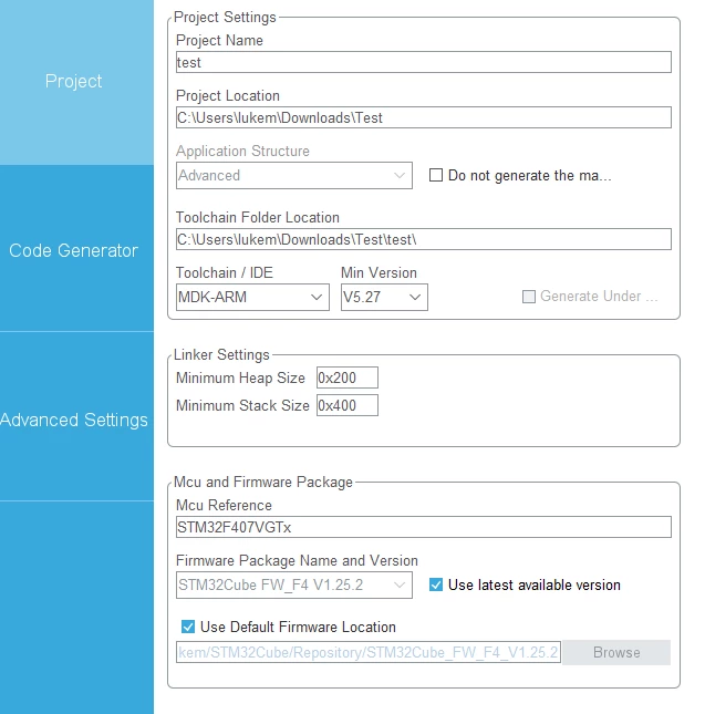

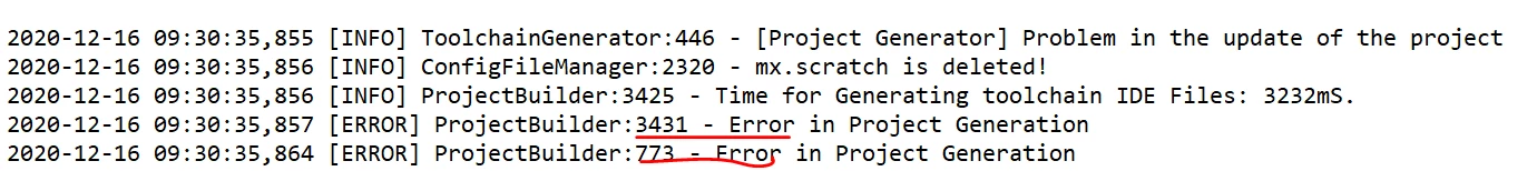

I am having an issue with the latest version of Cube MX when generating the code. Would appreciate if anyone can help. I suspected it was where I was storing it I tried dropbox/onedrive/documents and even downloads and still getting the same issue.
Please see the images attached:
Project Manager.
Error Message after project generation.
STM32 Cube MX logfile with Error Message.
CUBE MX Version: STM32Cube MCU Package for STM32F4 Series 1.25.2

Hi LMyle.1,
Thanks for quick reply, as I can from the .log file you have attached, you're using an unsupported Java version (Detected Java Version = 15.0.1) which is the reason behind this issue.
Actually JAVA Versions 7, 9, 10, 12 and upper are not supported. For more details about the CubeMX software requirements, please refer to the STM32CubeMX User Manual.
To solve the issue, you have to uninstall the current Java in your machine and install a supported version:
  • Minimum JRE version is 1.8_45 (known limitation with 1.8_251)
  • Version 11 is supported
Hope this will solve your problem.
Khouloud.
