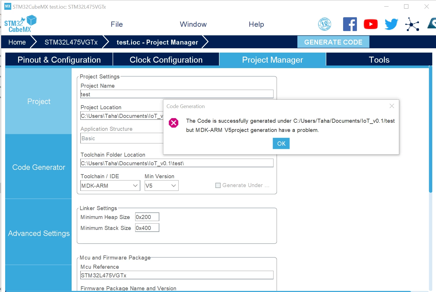

I am having a problem generating code for MDK-ARMV5.
I have already looked at others post regarding this problem but none of the solutions seems to work.

Can we give us the java version ?

I experienced the same problem.
This is probably because there is a space or "." In the project folder name.
I avoided the problem by rewriting the folder names to simple alphanumeric characters.

I have the same problem. The folder name is simple, but the problem remains.

The folder names are simple. The problem remains.
Keil version 5.29.0.0
CubeMX 5.6.0
