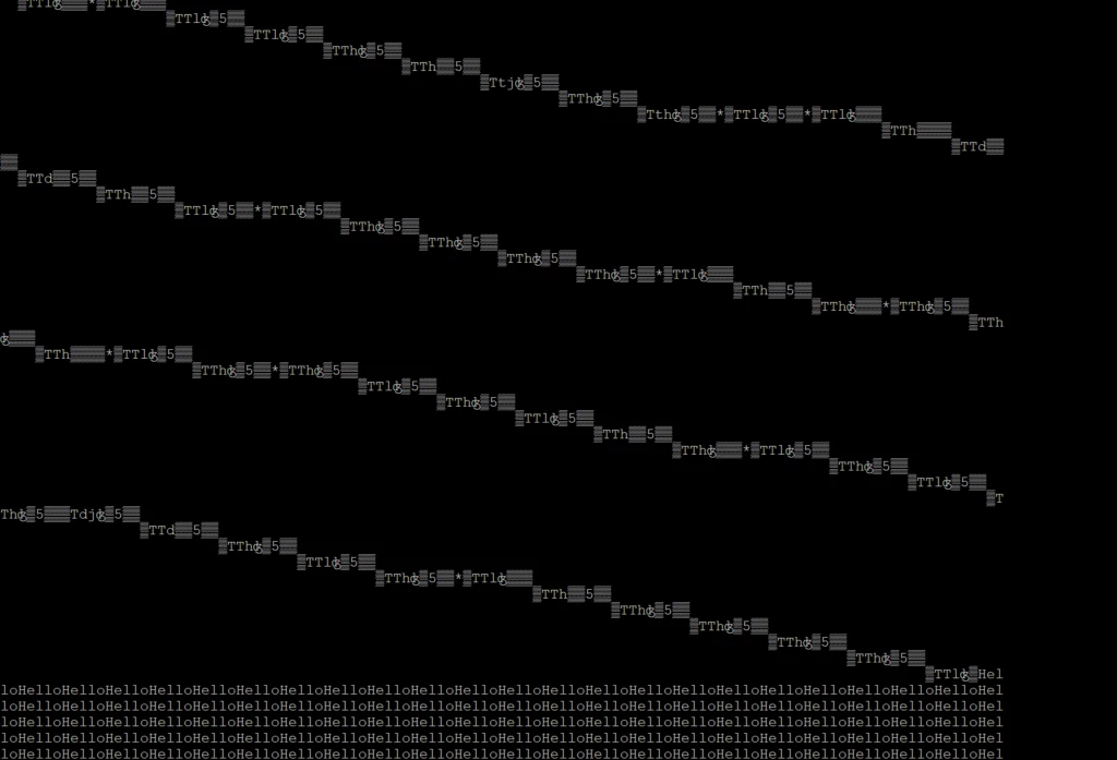

HSI clock config is not correct for NUCLEO L432KC, with drivers version 1.16
I have setup UART1 clocked with HSI clock, with drivers version 1.16
Which led to incorrect output on the line.
0693W00000BdfgFQAR.pngSame code with drivers version 1.14 worked completely fine. See picture.

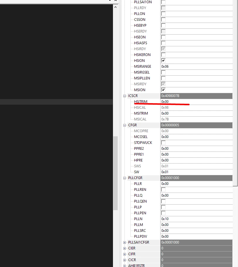

Turns out HSI trimming value is not correct in clock setup
 RCC_PeriphCLKInitTypeDef PeriphClkInit = {0};
 /** Initializes the CPU, AHB and APB busses clocks
 RCC_OscInitStruct.OscillatorType = RCC_OSCILLATORTYPE_HSI;
/* RCC_HSICALIBRATION_DEFAULT seems to be wrong */
 RCC_OscInitStruct.PLL.PLLState = RCC_PLL_NONE;
 Error_Handler();
in different versions of drivers it is hardcoded to different value:
v 1.14 - 0x10u
v 1.16 - 0x40u
Also, when I entered debug mode and checked actual value in the register, in first case it was the same, but in second case it was 0, instead of 0x40u.
 0693W00000BdflKQAR.pngSubstituting value manually to 0x10u solved the issue.
Please, check it.
TDKBest answer
Jul 14, 2021 1:27 PM UTC
Sadly, this is a longstanding issue that was introduced in July 2020 and still persists a year later. What's worse is the older version of HAL worked correctly in this regard.
