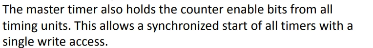

Synchronization between timers can be done by master timer (or by another synchronization source). See please the presentation obout HRTIM and find there "master timer" function explanation . In STM32G4CubeFW is included example for mater timer for HRTIM (for Nucleo board: HRTIM_Basic_PWMMaster).

Hi @Igor Cesko , thats a great presentation, how do we "click" that functionality in cubeMx?
Or do we go direct register access with this basic functionality
