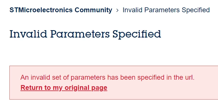

February 6, 2024
Would you mind posting the answer? The link you posted doesn't work. All I get is this:
