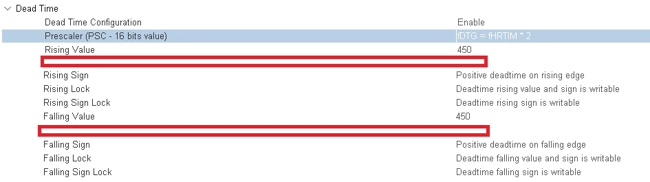

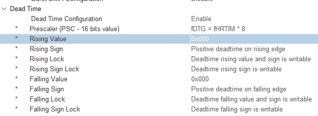

Hello, is it possible to add a feature in CubeMX deadtime section in HRTIM (STM32F3, STM32G4 and STM32H7)?
In Time Base Setting, whenever you change the "Period" setting, the resulting frequency will show.
Is it possible to add the same feature when you change the Rising/Falling value and will show how much time it consumes?

This is a feature request.
AS show below, you can check immediately the resulting Freq by changing the period numerically.
Hopefully there is a similar info when you change the deadtime Rising/Falling Value, like how long will the deadtime incur.

Hello @Nesrine.JLASSI​ ,
If you calculate the resulting PWM freq as shown below
like this formula:
HRTIM_Freq = HAL_RCC_GetHCLKFreq() * pTimeBaseCfg.PrescalerRatio / pTimeBaseCfg.Period
then dead time can be calculated like this:
HRTIM_deadtime(rising/falling) = pDeadTimeCfg.RisingValue / ( HAL_RCC_GetHCLKFreq() * pDeadTimeCfg.Prescaler )
And you can insert inside the RedBox the value as shown below.
