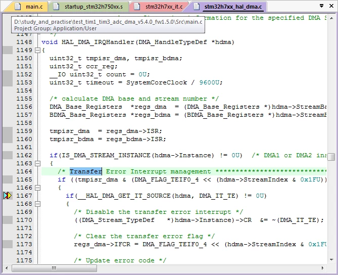

How to use usart + dma ?
hi, Dear, how can I use usart + dma? I make the project by stm32cubeMx and add some code in main function as below: but it run fail and show a dma transfer error(Show as addition files: RunHere.png). Looking for your reply , Thank you!

You'd presumably need to use a callback to flag if the transfer completed. And then wait before sending again.​

Are you meaning add a callback function like below:
void HAL_UART_TxCpltCallback(UART_HandleTypeDef *huart)
  if (huart == &huart1)  {
     ctlUart.f_TxBusy = FALSE;

I had a similar issue where only the first DMA transmission would work, and found the fix was to enable HAL_UART_IRQHandler()
See this thread for more details:
https://community.st.com/s/question/0D50X00009XkgtY/dma-uart-with-hal-remain-busy-bug
