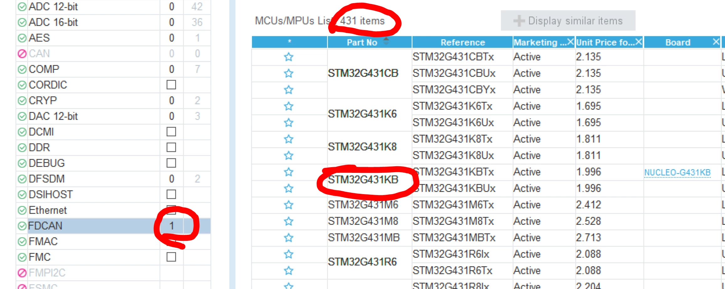

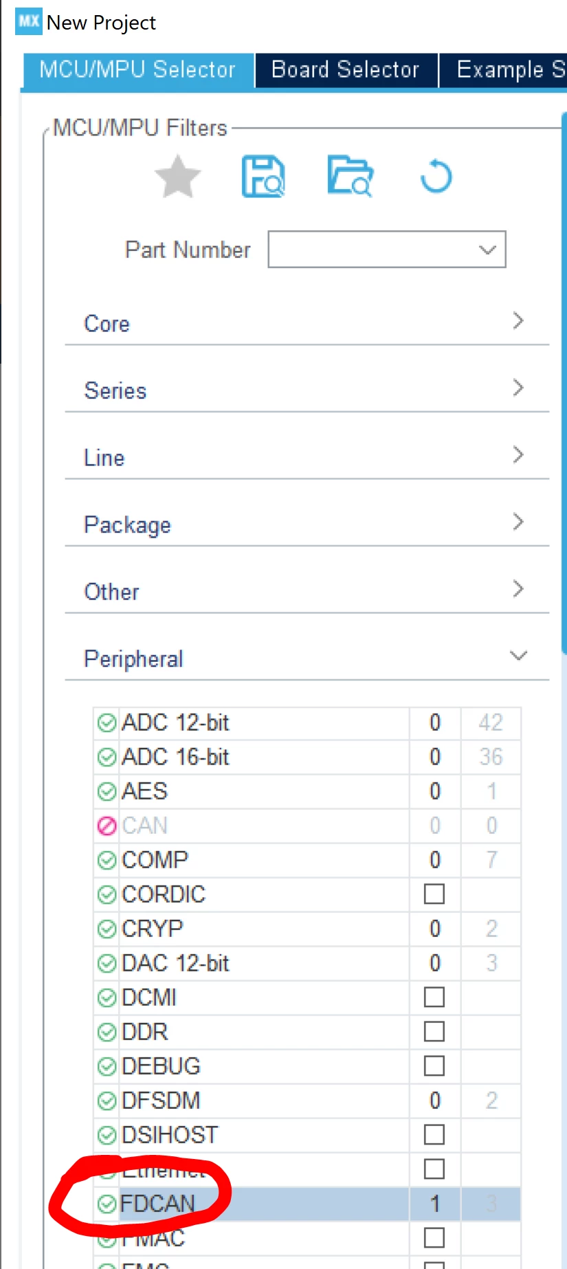

> Open CubeMX (v4.23.0 (2021), MacOS)
The latest version is 6.1.1, and works fine for me:

Jan 3, 2021 3:14 PM UTC
Not sure on the answer to your question, but you can use the MCU/MPU Selector within STM32CubeMX to do the same thing. There is both a CAN and an FDCAN selection:

Jan 4, 2021 1:59 PM UTC
@TDK​: Don't know why my "About" screen showed "2021" in the version info, but indeed it was a very old version (verified it on an older laptop of mine).
I retested this on another machine, updating to 6.1.1 and I can indeed reproduce your behaviour - thanks for pointing me in the right direction!
By the way, in case other readers see this thread in the future, USB-PD is also selectable as "UCPD" peripheral in CubeMX v6.1.1.
