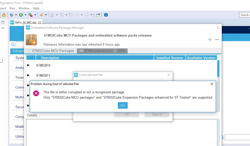

Hello @SBS.1​
Following the link you provided:

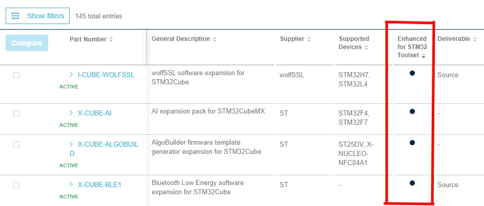

https://www.st.com/en/embedded-software/stm32cube-expansion-packages.html#products
Only the expansion package tagged as "Enhanced for STM32 Toolset" can be open with STM32CubeMX.
Those ones can also be found and downloaded from STM32CubeMX.
The others, as mentioned by @Mikhail Z​ are just standard zipped archives.
