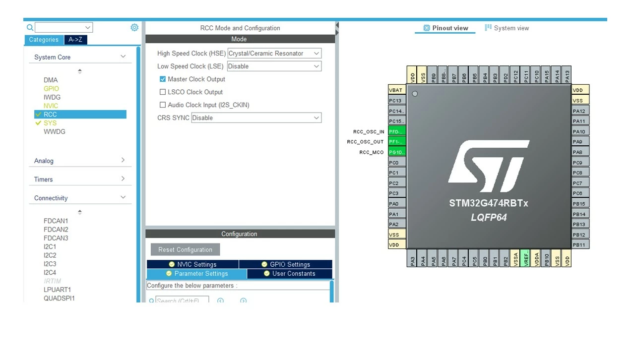

How to use MCO at PG10/NREST Pin with STM32G474RE? Init. code from STM32CubeMX always works at PA8 Pin as MCO function.

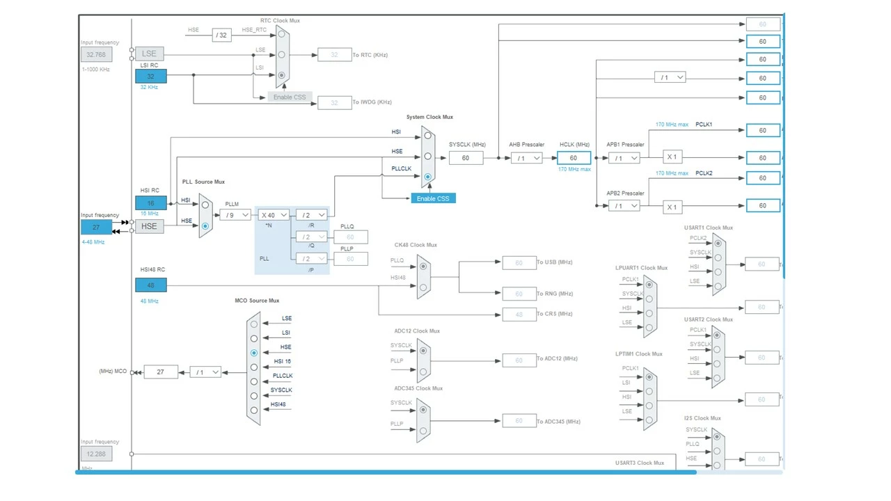

I am working with a STM32G474RE and I want to use a MCO as an output of HSE(27MHz).
I used STM32CubeMX Ver.5.6.1 for generate simplest init. code, which would work only for MCO function at PG10 Pin.
here's my setup.
I builded the init. code by SW4STM32 without any modification.
27MHz crystal is connected betoween PF0 and PF1.
I measured wave form at PG10 and PA8 Pin by oscilloscope.
PG10 wave form was tied to 3.3V DC, and PA8 wave form was 27MHz clk signal.
I thought that I must write something to set PG10 as standard GPIO in order to avoid confliction with NRST function. Therefore, I can't find how to do it.
Thank you.

You need to enable PG10 as GPIO pin, see description of PG10_Mode field in option bytes, and the Using PG10 as GPIO chapter in RM.
Note that you will lose the possibility to reset the chip using a signal, i.e. you won't be able to "connect under hardware reset" the debugger (useful e.g. if you change the functionality of SWD pins in software).

How was GPIO_OSPEEDR set for PG10?
庄勇輝.1
Apr 18, 2020 1:18 AM UTC
That setting was "LOW" when PG10 output was 1Vpp.
I modify it as ​GPIO_OSPEEDR  = "VERY_HIGH".
Now, PG10 output amplitude become 3.3Vpp!!
And, PA8 still output the same signal as PG10.
