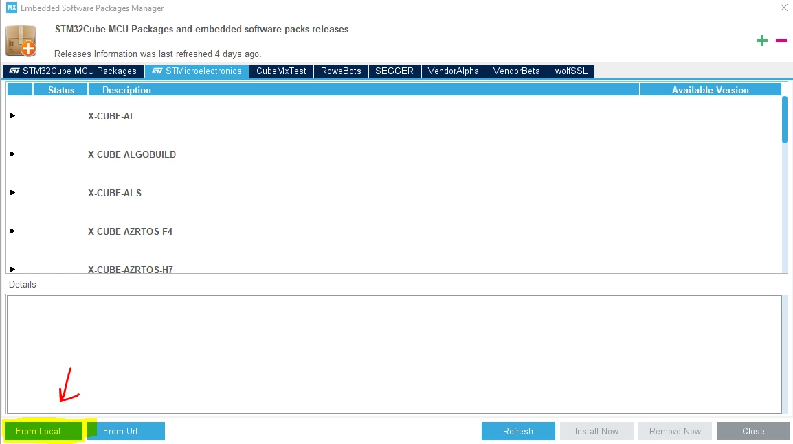

Hello @Community member​ ,
Sorry for the delay,
To import an external pack on CubeMX, you need to use the From Local option under Help/Manage embedded Software package, as mentioned in the image below, if it does not work for you, please provide me more details/ steps to be able to reproduce your issue.
Thanks, Khouloud
