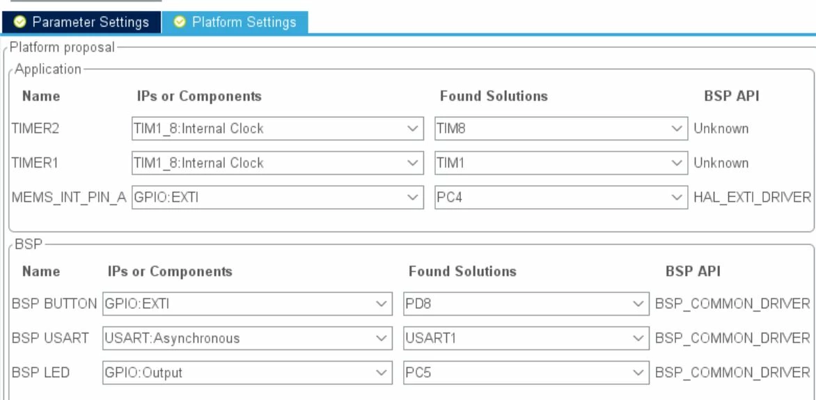

how to use algobuild in cubemx?
  • November 18, 2020
  • 4 replies
  • 2529 views
I tried but it didn't work.
0693W000005Bl0UQAS.jpgthese setting is right?
it makes error at TIM_AB_Config()
Has anyone succeeded to use x-cube algobuild?

Hello @kdok .1​
Could you please share your ioc file ?
Thanks
Khouloud

Yes.
Do you have a manual from ground up?​

there's an example under repository which use ALGOBUILD , it may help you : \Repository\Packs\STMicroelectronics\X-CUBE-ALGOBUILD\1.1.0\Projects\STM32L152RE-Nucleo\Applications\IKS01A3\NUCLEO-L152RE_IKS01A3

Hi @kdok .1​ ,
Using your ioc file, there's a many compilation errors
It will be internally checked, thanks for your feedback.
