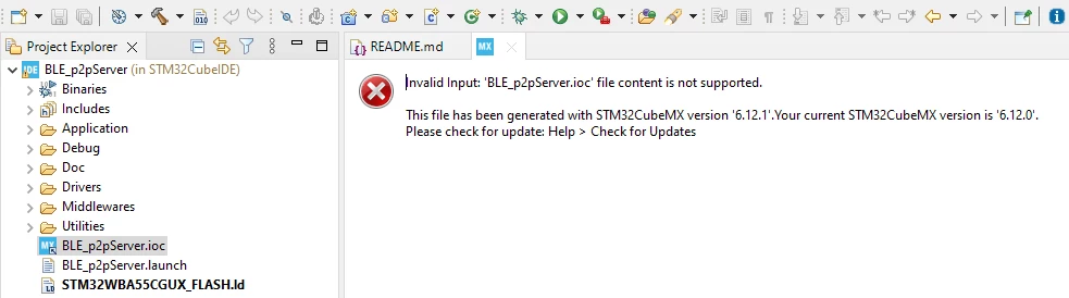

i want to import BLE_p2pServer example in CubeIDE 1.16.0 i got the message "This file has been generated with STM32CubeMX version '6.12.1'.Your current STM32CubeMX version is '6.12.0'."

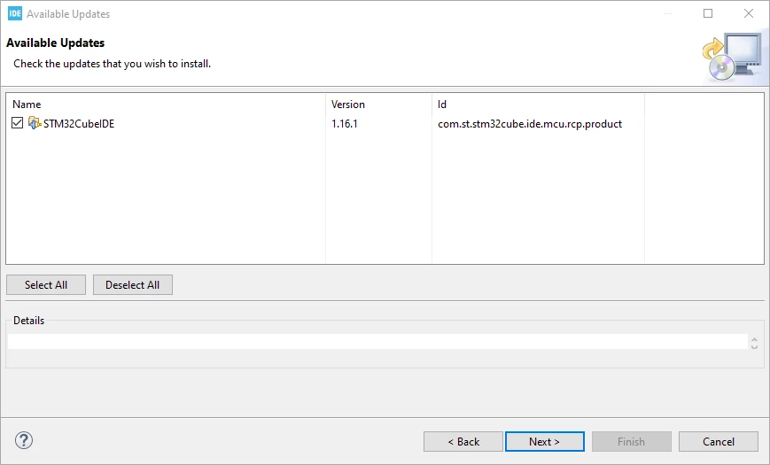

When i check for Updates, then I only have the option of updating CubeIDE itself to V1.16.1. How can I update CubeMx to V6.12.1 without updating CubeIDE? I think CubeMx is part of CubeIDE or do I have to install cubeMx separately?

Hello @ledi001
CubeMX 6.12.1 is integrated in CubeIDE 6.12.1 so just update the CubeIDE and you will be able to work with your IOC generated with CubeMX 6.12.1

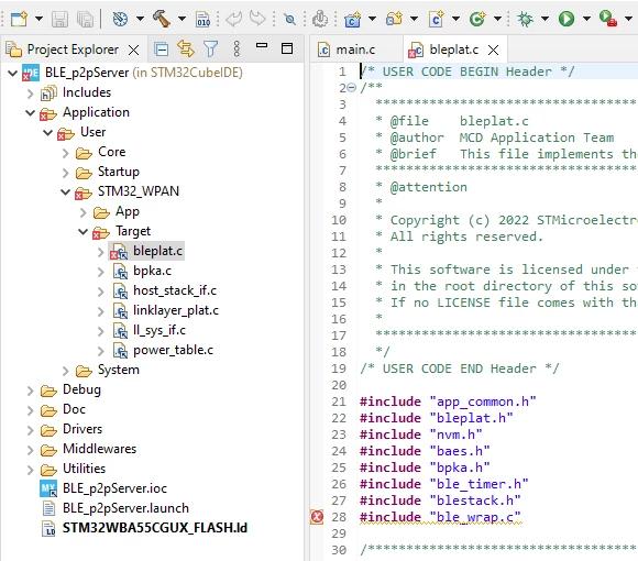

I think you mean CubeMX 6.12.1 is integrated in CubeIDE 1.16.1 and not in CubeIDE 6.12.1, right?
Ok, i did the update to CubeIDE 1.16.1, and first it seams to work, but unfortunately i got some erros after compiling.
Then i cleaned up the project, but the errors remained (it seems that ble_wrap.c is not found:
C:/Users/Admin/STM32CubeIDE/workspace_1.16.0/BLE_p2pServer/STM32_WPAN/Target/bleplat.c:28:10: fatal error: ble_wrap.c: No such file or directory
28 | #include "ble_wrap.c"
compilation terminated.
make: *** [Application/User/STM32_WPAN/Target/subdir.mk:34: Application/User/STM32_WPAN/Target/bleplat.o] Error 1
make: *** Waiting for unfinished jobs....
"make -j8 all" terminated with exit code 2. Build might be incomplete.
16:23:03 Build Failed. 3 errors, 0 warnings. (took 7s.789ms)

And what I also noticed is that nothing is displayed in the Build Analyzer window...

Use standalone CubeMX. Can install several versions side by side.
