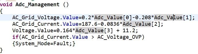

I am new to STM32 MCU and right now using a 170MHz STM32G474 MCU for my project. I did a test today and found out the float number calculation speed of the MCU is quite slow.
It takes 6.3us to finish the calculation in Fig.1. (I set a GPIO pin high before the calculation starts and set it to low after the calculation). ADC_Value[] is integer and the rest variables are float. The speed is just too slow to believe.

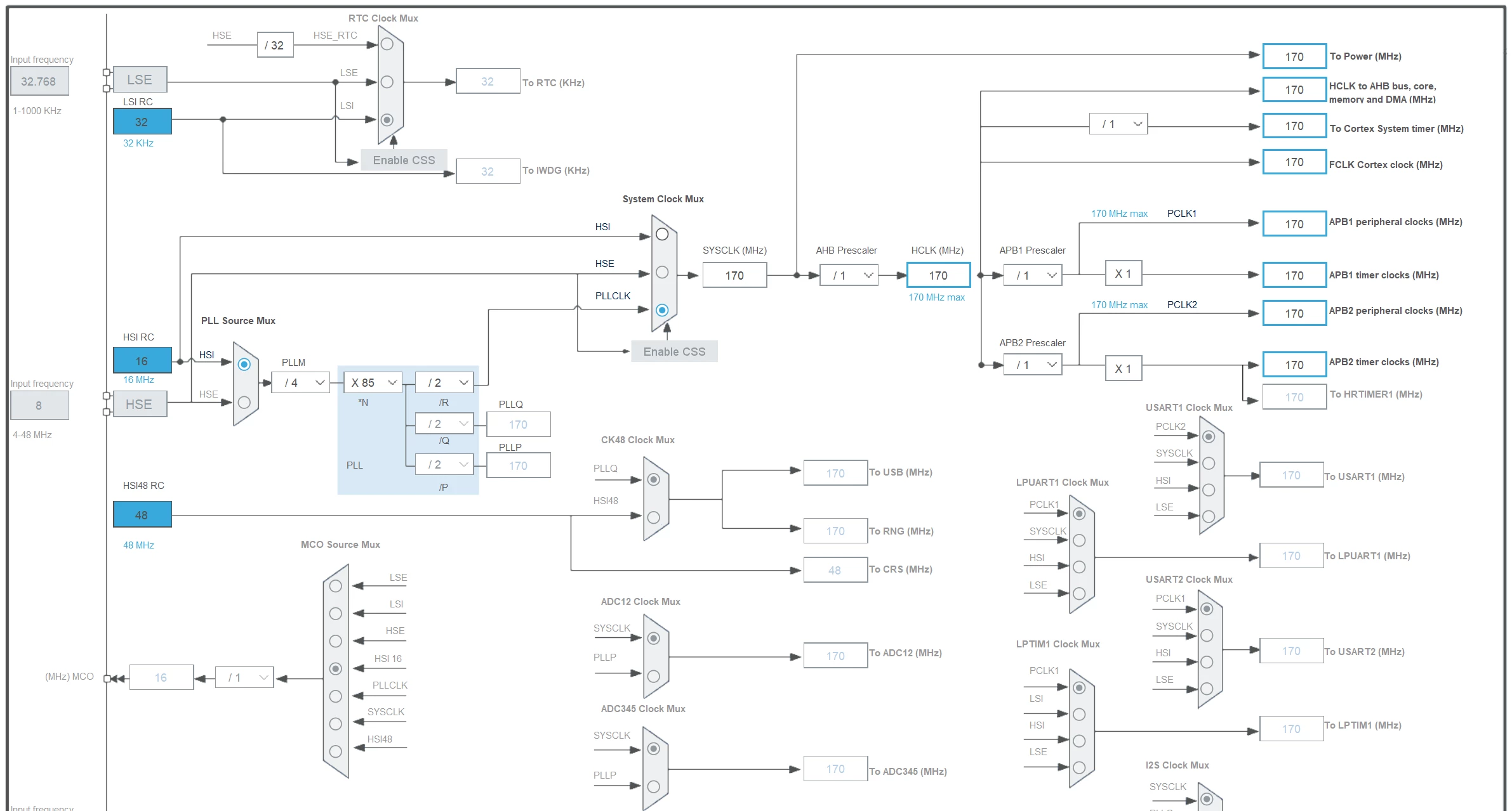

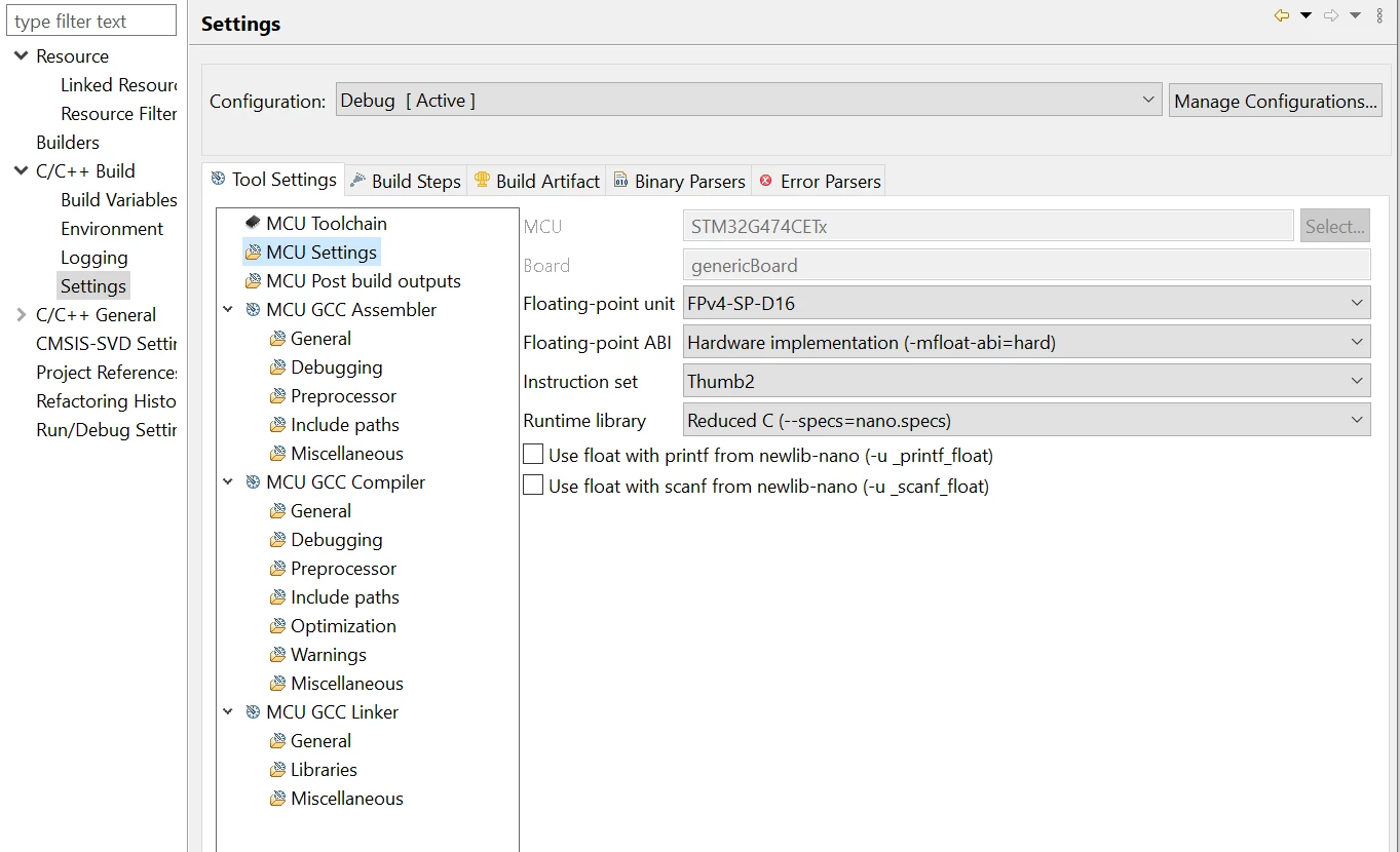

The clock is set to be 170MHz. Am I missing something in the project setting (shown in Fig2 and Fig3)? Is this the real calculation speed for the MCU?

Try to change ALL const value to float as said by Tesla...​
For example​ use 0.2f instead of 0.2 (the Last one is a double !)

If you don't need mantisse, why not stick to fractional binary like Q31, or calculate with pre.multiplied values by 1024? FMAC I guess is an IP to contemplate.
Otherwise, check your project settings, use of FPU vs sw emulated library, compiler optimisatipn mode, etc....

Check the generated code, check it's using float constants

Thanks for the example. I changed all the numbers to float format and used the -Ofast optimizer in the GCC Compiler Optimization setting. The calculation time length is reduced by 85% -- a much reasonable number. Thanks!
