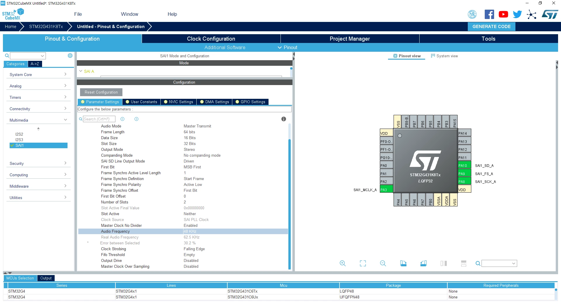

How to set SAI(I2S/TDM4) register of STM32G4(or STM32F4, STM32F7)
  • June 23, 2020
  • 1315 views

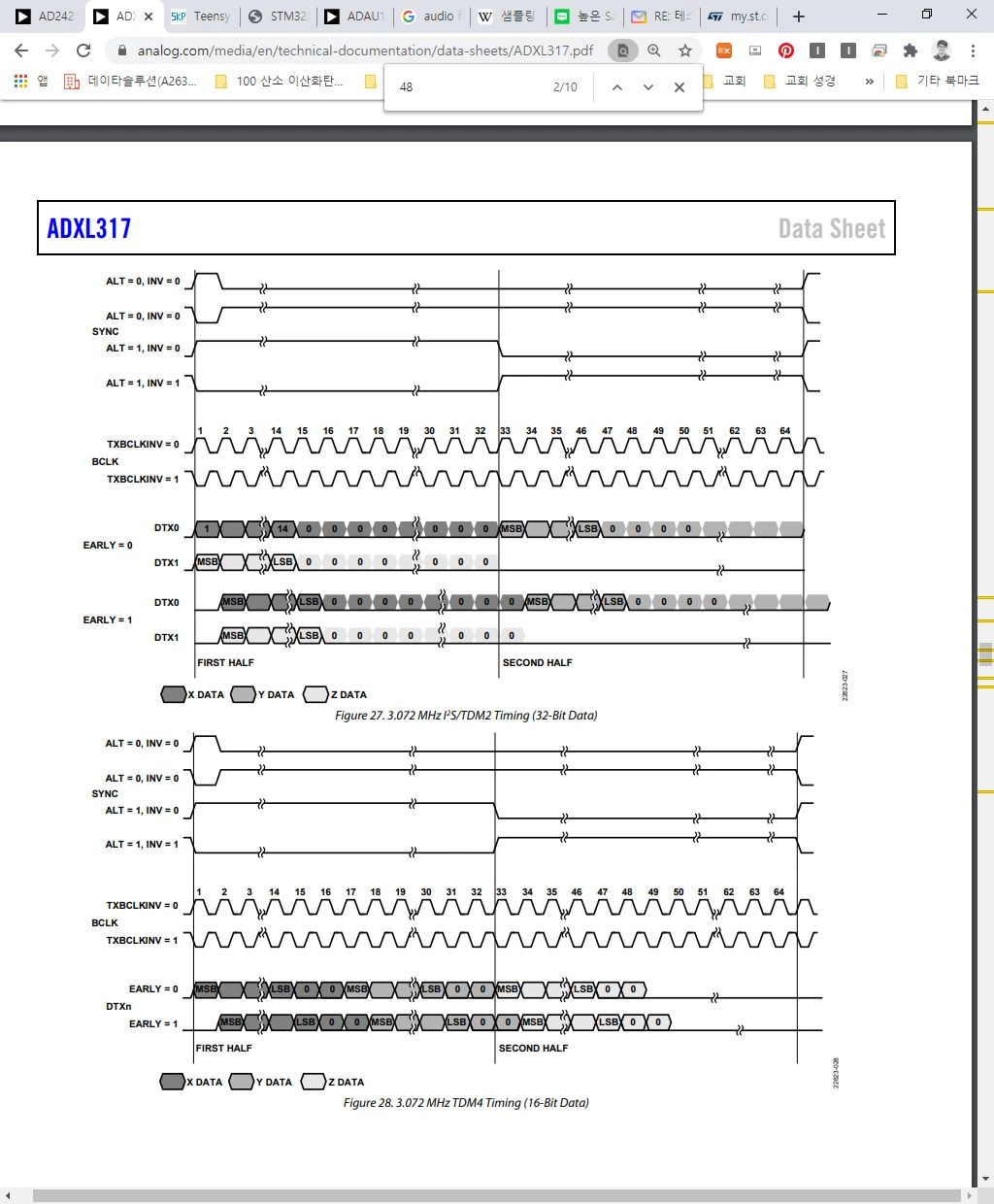

I need advice on setting up I2S of ADXL317 IC.
I am trying to set up using CUBEMX, but the timing is not correct
BCLK is not 3.072Mhz, 2.12Mhz comes out
As shown in the picture below, what part settings need to be changed to match the timing?
2 replies
June 23, 2020
Your system clock speed needs to be a multiple of 256 times the target audio frequency. A clock of 160MHz will get you pretty close.
