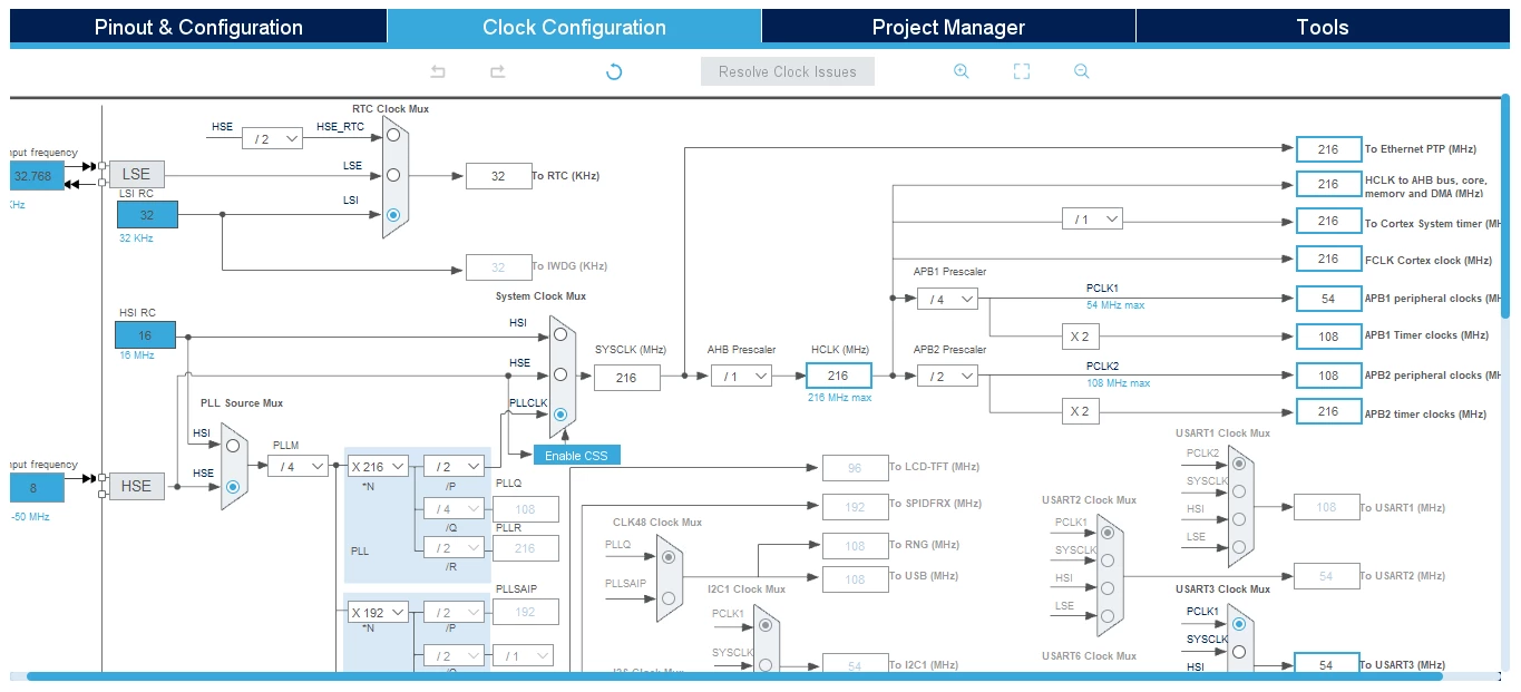

How to set Prescaler and Period value for F767ZI to calculate the execution time of the function?
  • September 20, 2019
  • 3 replies
  • 2437 views
This is my clock configuration.
This is setting for TIM1,
 htim1.Instance = TIM1;
 htim1.Init.Prescaler = 7999;
 htim1.Init.CounterMode = TIM_COUNTERMODE_UP;
 htim1.Init.Period = 1999;
 htim1.Init.ClockDivision = TIM_CLOCKDIVISION_DIV1;
 htim1.Init.RepetitionCounter = 0;
 htim1.Init.AutoReloadPreload = TIM_AUTORELOAD_PRELOAD_DISABLE;
 if (HAL_TIM_Base_Init(&htim1) != HAL_OK)
 Error_Handler();
 sClockSourceConfig.ClockSource = TIM_CLOCKSOURCE_INTERNAL;
 if (HAL_TIM_ConfigClockSource(&htim1, &sClockSourceConfig) != HAL_OK)
 Error_Handler();
 sMasterConfig.MasterOutputTrigger = TIM_TRGO_RESET;
 sMasterConfig.MasterOutputTrigger2 = TIM_TRGO2_RESET;
 sMasterConfig.MasterSlaveMode = TIM_MASTERSLAVEMODE_DISABLE;
 if (HAL_TIMEx_MasterConfigSynchronization(&htim1, &sMasterConfig) != HAL_OK)
 Error_Handler();
This is how I'm measuring the time for function,
 TIM1 -> CR1 |= TIM_CR1_CEN;
status = RSA_Encrypt(&PubKey_st, Message, sizeof(Message), output);
sprintf((char*)buf1,"ET:%d.%3d S \r\n",(uint)TIM1->CNT/1000 , (uint)TIM1->CNT%1000 );
 HAL_UART_Transmit(&huart3, (uint8_t*)buf1, 15, 100);
What is wrong with the timer? it say it takes 8 seconds to complete the 2048 RSA encryption decryption! As I change the values of prescaler and period the timing changes.
Can anybody plz tell me what would be the exact values of those?
I don't want any other techniques to measure the execution time. This is what I suppose to make it run.
Any kind of help is appreciated.

Tesla DeLorean
Guru
September 20, 2019
Use TIM2, set the Period to maximal, ie 0xFFFFFFFF
Set the prescaler to the clock frequency MHz-1
ie 99 for 100 MHz TIMCLK
Then CNT will count off in microseconds.
You could also use DWT_CYCCNT to time things in CPU cycles.​
Tesla DeLorean
Guru
September 21, 2019
As a sanity check use
uint32_t start, total;
start = HAL_GetTick();
total = HAL_GetTick() - start;
printf("Expired Time %d ms\n", total);

Thank you so much.. Going with HAL_GetTick().
