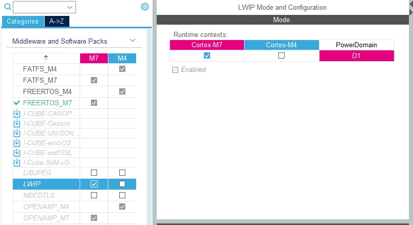

but when I try to check LWIP in [Pinout & Configuration] of IOC file,
I can't set [Enabled] of [LWIP Mode and Configuration]
It is disabled. I dont know why.

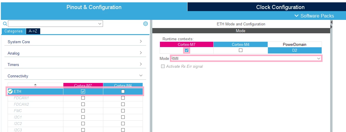

1- Configure the ethernet as shown in the below figure ( RMII mode for example)

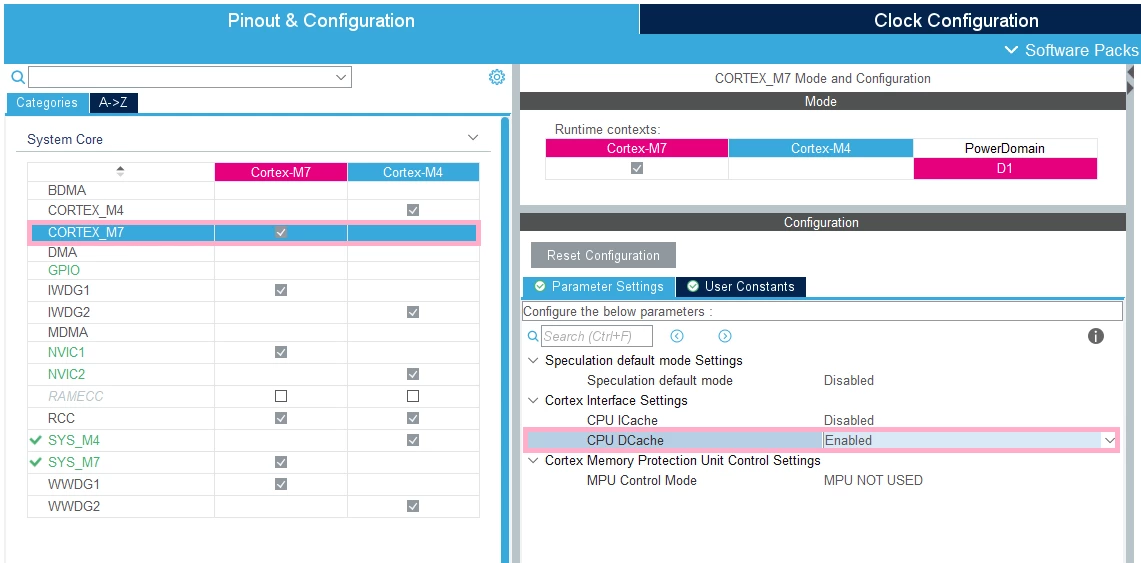

_legacyfs_online_stmicro_images_0693W00000bhrRoQAI.png2- Enable the DCache

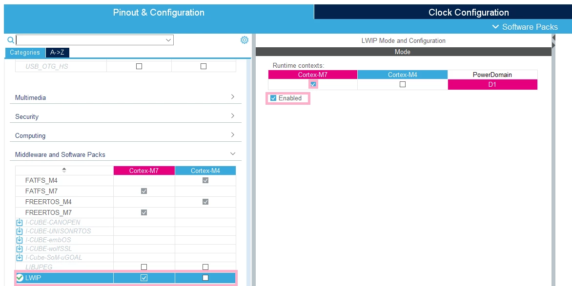

_legacyfs_online_stmicro_images_0693W00000bhrVGQAY.png3- Enable LWIP

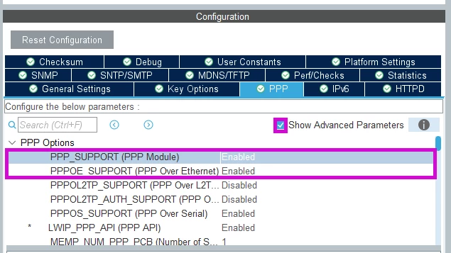

  • Use PPP_SUPPORT requires PPPOS_SUPPORT, PPPOE_SUPPORT or PPPOL2TP_SUPPORT turned on.
  • PPP_SUPPORT needs also PPP_IPV4_SUPPORT and/or PPP_IPV6_SUPPORT turned on.
For that, please refer to the below figure.
0693W00000aJYoCQAW.pngWhen your question is answered, please close this topic by choosing Select as Best. This will help other users find that answer faster.

I can't enable LWIP.
_legacyfs_online_stmicro_images_0693W00000bhrQWQAY.png​how can i set like you?

If I can't set ETH of connectivity, can I not use PPP?
ETH cannot be set because many pins of the STM32H747 are used for other purposes.
Are there any other ways to use PPP?
Thank you.

You can enable LWIP only if ETH IP is configured.
Thank you.
