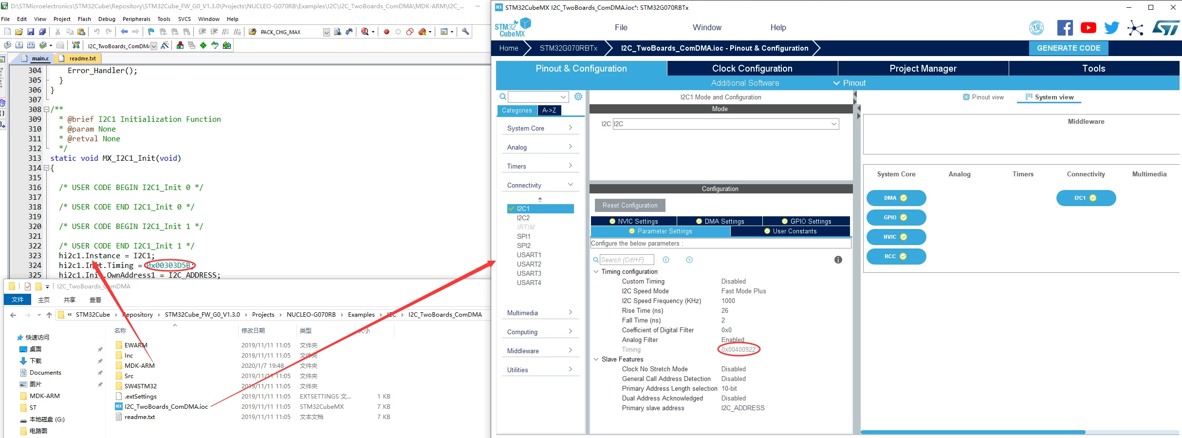

For example, using CubeMX to set the I2C, 400K rate, the TIMING parameter is automatically generated, but it is not 400K in actual operation. The timing value of the program in ST DEMO is different from that in CubeMX, so how can I use CubeMX to set the correct I2C timing?
D:\STMicroelectronics\STM32Cube\Repository\STM32Cube_FW_G0_V1.3.0\Projects\NUCLEO-G070RB\Examples\I2C\I2C_TwoBoards_ComDMA:

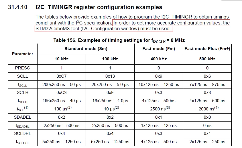

Please have a look to RM0444 / 31.4.10 and 31.7.5.
one V
one VAuthor
January 8, 2020
Thank you for your reply, but the manual here still says tha STM32CubeMX must be used to configure parameters.0690X00000BviFwQAJ.png
Mike_ST
January 8, 2020
Yes you are right, I saw that as well.
After reading such a sentence I would expect something better than filling a 32 bits value in the CubeMx.
Senior III
January 8, 2020
I agree that the .ioc file should reflect the generated code in the example, but this won't be the first time the example are not an exact match.
Regarding your question, use the fields I2C speed mode, I2C speed frequency, Rise time, Fall time, Coefficient of digital filter and Analog filter to generate the right I2C timing value. It is simple as that. There is no need to generate the corresponding code, you can just copy the result in your code.
