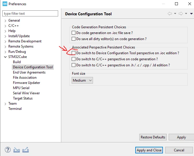

August 16, 2020
Uncheck all. Dont forget to apply.​
Here is snapshot where to act:
