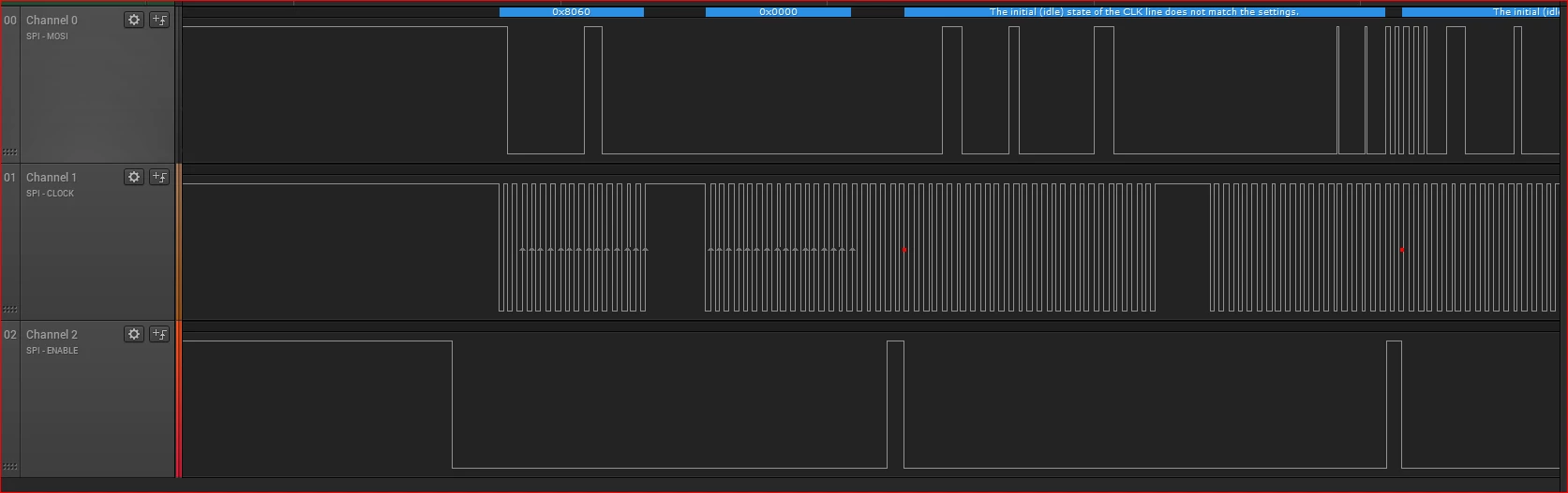

Hallo,

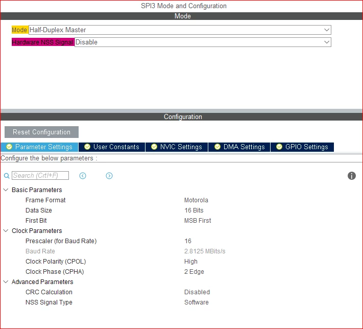

i dont unterstand how i can receive data in Spi Half-Duplex-Mode.
My used Controller is STM32F446RET.
Thats my Code:
HAL_GPIO_WritePin(CS_GPIOxLib, CS_GPIO_PinLib, GPIO_PIN_RESET);
 status = HAL_SPI_Transmit(hspiLib, (uint8_t*)&register_Address_calculation, 1, 10000);
 status = HAL_SPI_Receive(hspiLib, (uint8_t*)Value, 1, 10000);
 if(status != HAL_OK)
 Error_Handler();
 HAL_GPIO_WritePin(CS_GPIOxLib, CS_GPIO_PinLib, GPIO_PIN_SET);
A Logic Analyser shows that there are same Errors on the SPI when i try to receive.

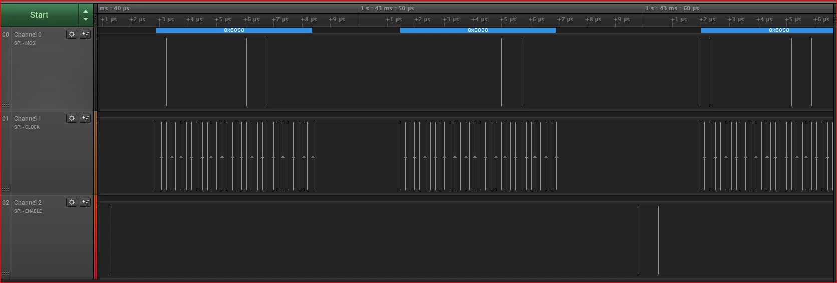

But when i changed
hspi3.Init.Direction = SPI_DIRECTION_1LINE;
to
 hspi3.Init.Direction = SPI_DIRECTION_2LINES;
the SPI looks better:
Is this wrong implemented by STM32Cube?

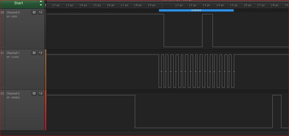

When i changed SPI Direction to
i can see, that STM32 dont spend clocks for receive
Is there anything wrong in my code?

If set to master and half-duplex (SPI_CR1.BIDIMODE=1), as soon as turned to Rx (SPI_CR1.BIDIOE=0), SPI starts to automatically output clocks (and shift in data) and does not stop until turned to Tx again. It means, you have to very carefully time the direction turns. Cube/HAL has probably no provision for this - it's one of the many specialty uses of STM32 hardware, and Cube/HAL covers inevitably only the most common modes of use.
