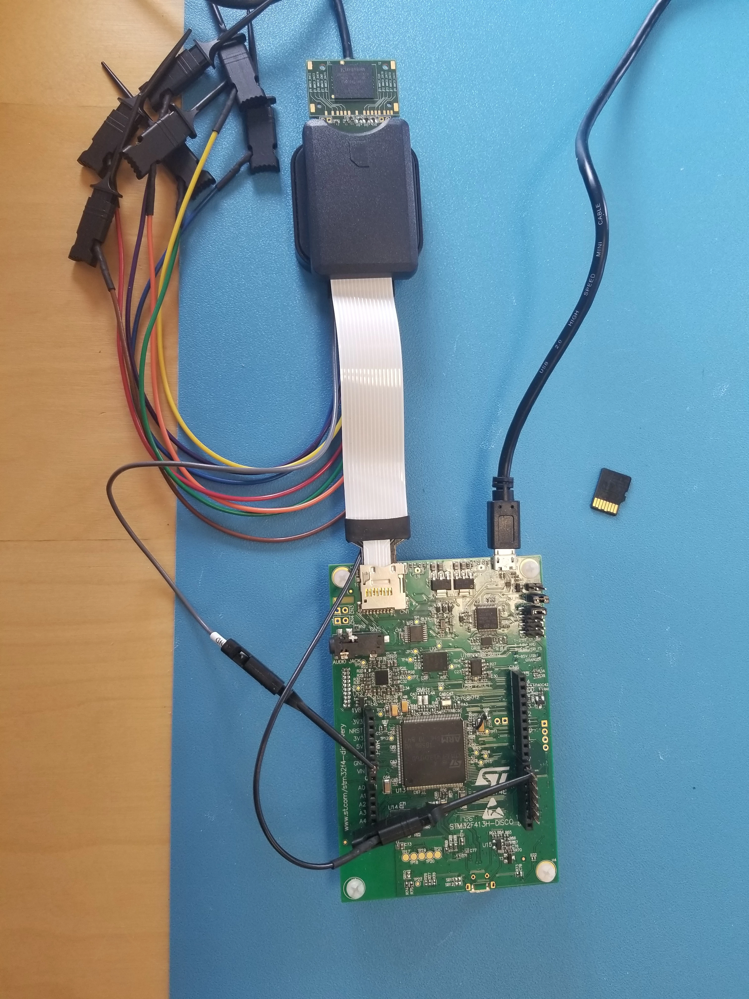

I am using :
  • STM32F413HDESCOVRY
  • STM32 CubeMX tool
  • Atollic TrueStudio V9.3
  • eMMC : Kingston EMMC04G
I already created the files
  • user_discio.c
  • user_discio.h
  • eMMC_Driver.c
  • eMMC_Driver.h
when i use f_mount i get FR_NO_FILESYSTEM
thx

Capacity seems all wrong for a 4GB eMMC, and I'm not sure I've coded to manage anything below 2GB
The ODROID cards with their MicroSD adapter connect more directly into the STM32 DISCO/EVAL boards.
Blank eMMC devices will need to be formatted. If you've validated the READ, and then WRITE functionality, you're ready to use f_mkfs()
I found these ODROID cards to be less of a circus
https://www.hardkernel.com/shop/8gb-emmc-module-c2-android/

STM32F413H-DISCO eMMC test code, blind port, I don't own this board.
Outputs via VCP at 115200 8N1, at first prompt hit ENTER, will prompt to format if necessary.
McherifAuthor
April 3, 2019
Thank you for your reply. I tried your source code it happens to connect with the eMMC but it can neither write nor erase. I tested it with several eMMCs always the same thing in the attached file you find all msg.
