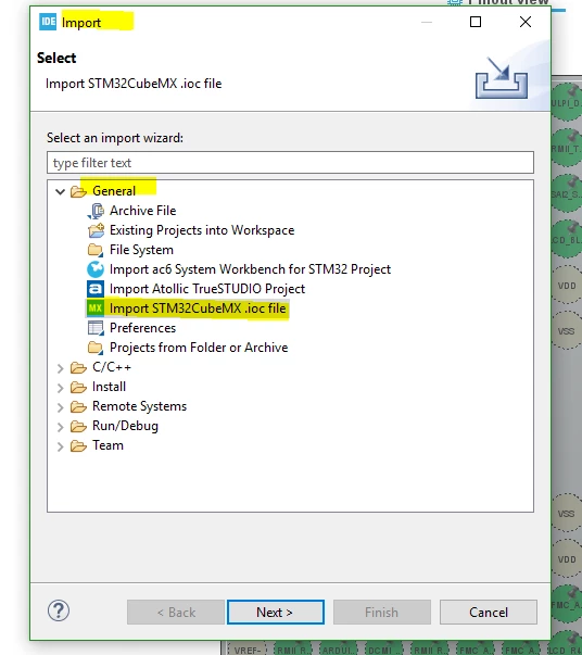

Nesrine.JLASSI
Visitor II
Jan 27, 2020 12:56 PM UTC
Hello @SKris.1616​
To import a project into STM32CubeIDE which is generated by STM32CubeMX, try to follow the next steps:
  1. Open CubeIDE v1.2.0
  2. Go to File => Import => General => Import STMCubeMX.ioc file0690X00000Bwc2PQAR.png
Best regards,
Nesrine

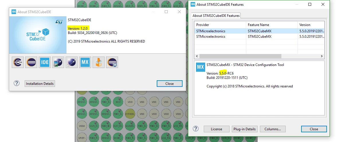

Nesrine.JLASSI
Visitor II
Jan 27, 2020 1:10 PM UTC
Hi @SKris.1616​
Please try with the lasted version of STM32CubeIDE (1.2.0).
Best regards,
Nesrine

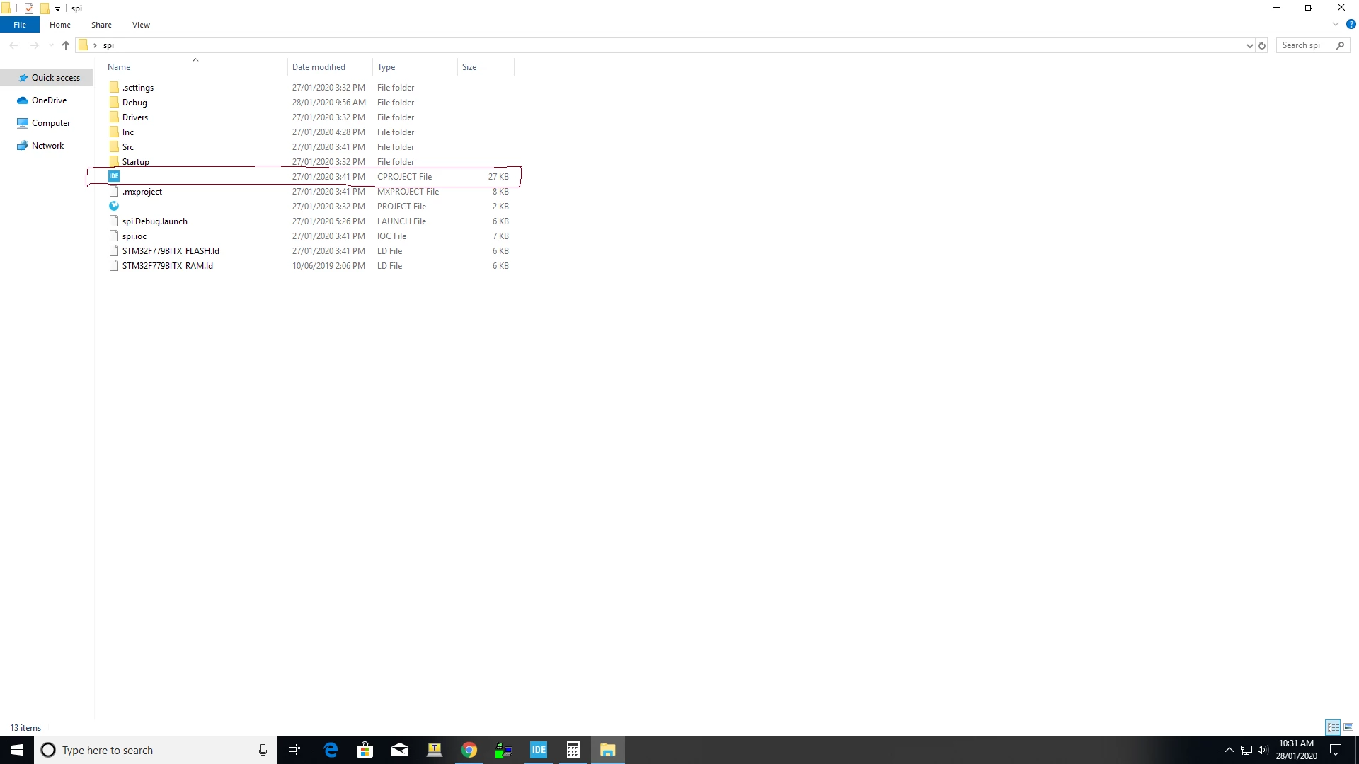

dbgarasiya
Senior
Jan 28, 2020 5:04 AM UTC
jsut open project folder and stmcube ide,
and double click on CPROJECT file , you will automatically open it
i have attached sceeenshot for you
dbgarasiya
Senior
Best of lcuk
