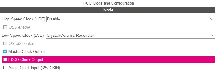

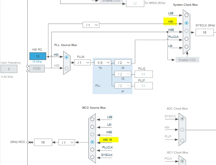

how to i route the internal HSI16 clock to MCO pin of STM32G071?
hello,
i use a NUCLEO-G071RB board and want to route the internal HSI16 clock to MCO pin (Pin12).
First i created a board project with CubeMX and aktivated the MCO pin. Then i set HSI16 as default clock and routed the clock signal to MCO pin. After code generation and starting the programm i cant measure a signal on MCO pin.

There is that RCC function that you may want to call:
 * @brief Select the clock source to output on MCO pin(PA8).
 * @note  PA8 should be configured in alternate function mode.
 * @param RCC_MCOx specifies the output direction for the clock source.
 *         For STM32G0xx family this parameter can have only one value:
 *           @arg @ref RCC_MCO1 Clock source to output on MCO1 pin(PA8).
 * @param RCC_MCOSource specifies the clock source to output.

Read out and check the respective RCC registers (RCC_CFGR), and check in respectrive GPIO_MODER if the given pin is set to AF, and GPIO_AFR if the given pin's AF number is set appropriately for MCO (see pins AF table in datasheet).

oh, it is pin PA8...now it works!
Thank you!
