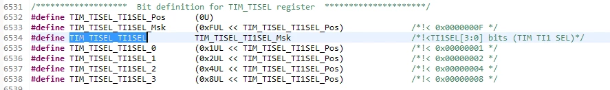

The call to HAL_TIMEx_TISelection() ends up performing this write to the TISEL register of TIM16
MODIFY_REG(htim->Instance->TISEL, TIM_TISEL_TI1SEL, TISelection);
Bit definitions

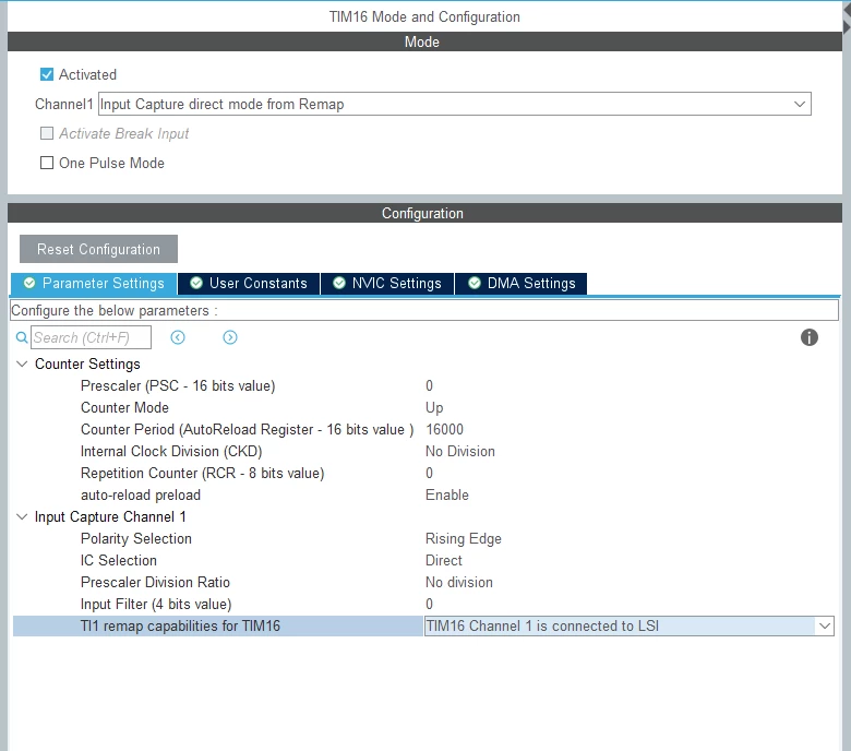

Here is my STM32CubeMX setup.
0693W00000NpWQjQAN.pngI am expecting roughly 1/2 Hz interrupt with a 16000 setting. Instead, I am getting 1mSec.
Any help is appreciated.

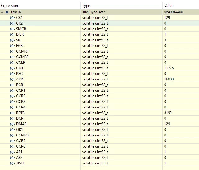

Read out and check/post TIM16 registers content.
RLour.1

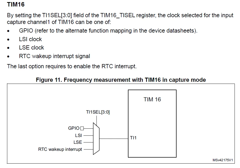

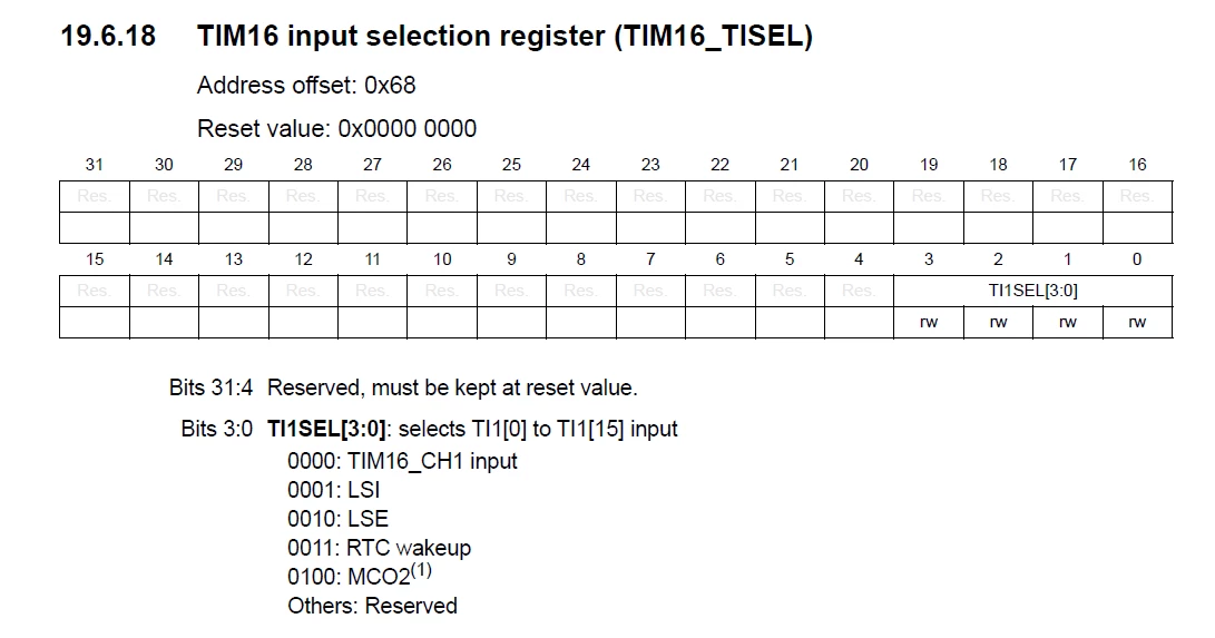

I am trying to clock TIM16 with LSI according to page 132 of the following manual.
From 132
	Details:0x40014400
	Default:0x40014400
	Decimal:1073824768
	Hex:0x40014400
	Binary:1000000000000010100010000000000
	Octal:010000242000
	Details:129
	Default:129
	Decimal:129
	Hex:0x81
	Binary:10000001
	Octal:0201
	Details:0
	Default:0
	Decimal:0
	Hex:0x0
	Binary:0
	Octal:0
	Details:1
	Default:1
	Decimal:1
	Hex:0x1
	Binary:1
	Octal:01
	Details:0
	Default:0
	Decimal:0
	Hex:0x0
	Binary:0
	Octal:0
	Details:3
	Default:3
	Decimal:3
	Hex:0x3
	Binary:11
	Octal:03
	Details:0
	Default:0
	Decimal:0
	Hex:0x0
	Binary:0
	Octal:0
	Details:0
	Default:0
	Decimal:0
	Hex:0x0
	Binary:0
	Octal:0
	Details:0
	Default:0
	Decimal:0
	Hex:0x0
	Binary:0
	Octal:0
	Details:7950
	Default:11776
	Decimal:11776
	Hex:0x2e00
	Binary:10111000000000
	Octal:027000
	Details:0
	Default:0
	Decimal:0
	Hex:0x0
	Binary:0
	Octal:0
	Details:0
	Default:0
	Decimal:0
	Hex:0x0
	Binary:0
	Octal:0
	Details:16000
	Default:16000
	Decimal:16000
	Hex:0x3e80
	Binary:11111010000000
	Octal:037200
	Details:0
	Default:0
	Decimal:0
	Hex:0x0
	Binary:0
	Octal:0
	Details:0
	Default:0
	Decimal:0
	Hex:0x0
	Binary:0
	Octal:0
	Details:0
	Default:0
	Decimal:0
	Hex:0x0
	Binary:0
	Octal:0
	Details:0
	Default:0
	Decimal:0
	Hex:0x0
	Binary:0
	Octal:0
	Details:0
	Default:0
	Decimal:0
	Hex:0x0
	Binary:0
	Octal:0
	Details:0
	Default:0
	Decimal:0
	Hex:0x0
	Binary:0
	Octal:0
	Details:129
	Default:129
	Decimal:129
	Hex:0x81
	Binary:10000001
	Octal:0201
	Details:0
	Default:0
	Decimal:0
	Hex:0x0
	Binary:0
	Octal:0
	Details:0
	Default:0
	Decimal:0
	Hex:0x0
	Binary:0
	Octal:0
	Details:0
	Default:0
	Decimal:0
	Hex:0x0
	Binary:0
	Octal:0
	Details:1
	Default:1
	Decimal:1
	Hex:0x1
	Binary:1
	Octal:01
	Details:8192
	Default:8192
	Decimal:8192
	Hex:0x2000
	Octal:020000
	Details:0
	Default:0
	Decimal:0
	Hex:0x0
	Binary:0
	Octal:0
	Details:0
	Default:0
	Decimal:0
	Hex:0x0
	Binary:0
	Octal:0
	Details:1
	Default:1
	Decimal:1
	Hex:0x1
	Binary:1
	Octal:01

I think I found my own answers. None of the timers can be clocked by the LSI. You can measure the LSI by using it as a gate for the counter, but not to drive the counter. Drat.

Indeed, TIM16 does not have the slave-mode controller so you can't use TIM16_CH1 as source for external clock mode.
The TIM15/16/17 chapter is confusing in that TIM15 has a different structure than TIM16 and TIM17 and I've looked at the wrong diagram (in RM444 the TIM15 block diagram is placed into the TIM16/TIM17 main features chapter...)
You still can use LSI as input clock to LPTIM or RTC.
