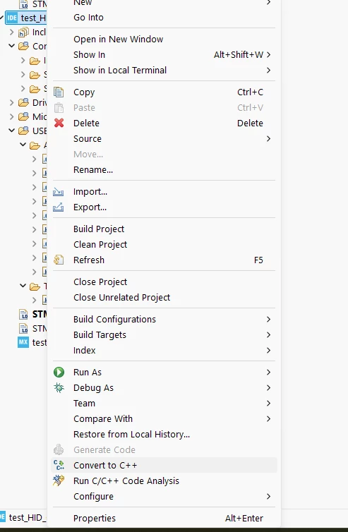

how to generate cpp project from stm32cube Mx
after selecting the pins from cube MX, it will generate code in c but i want that in cpp

Hello ​@siva_28

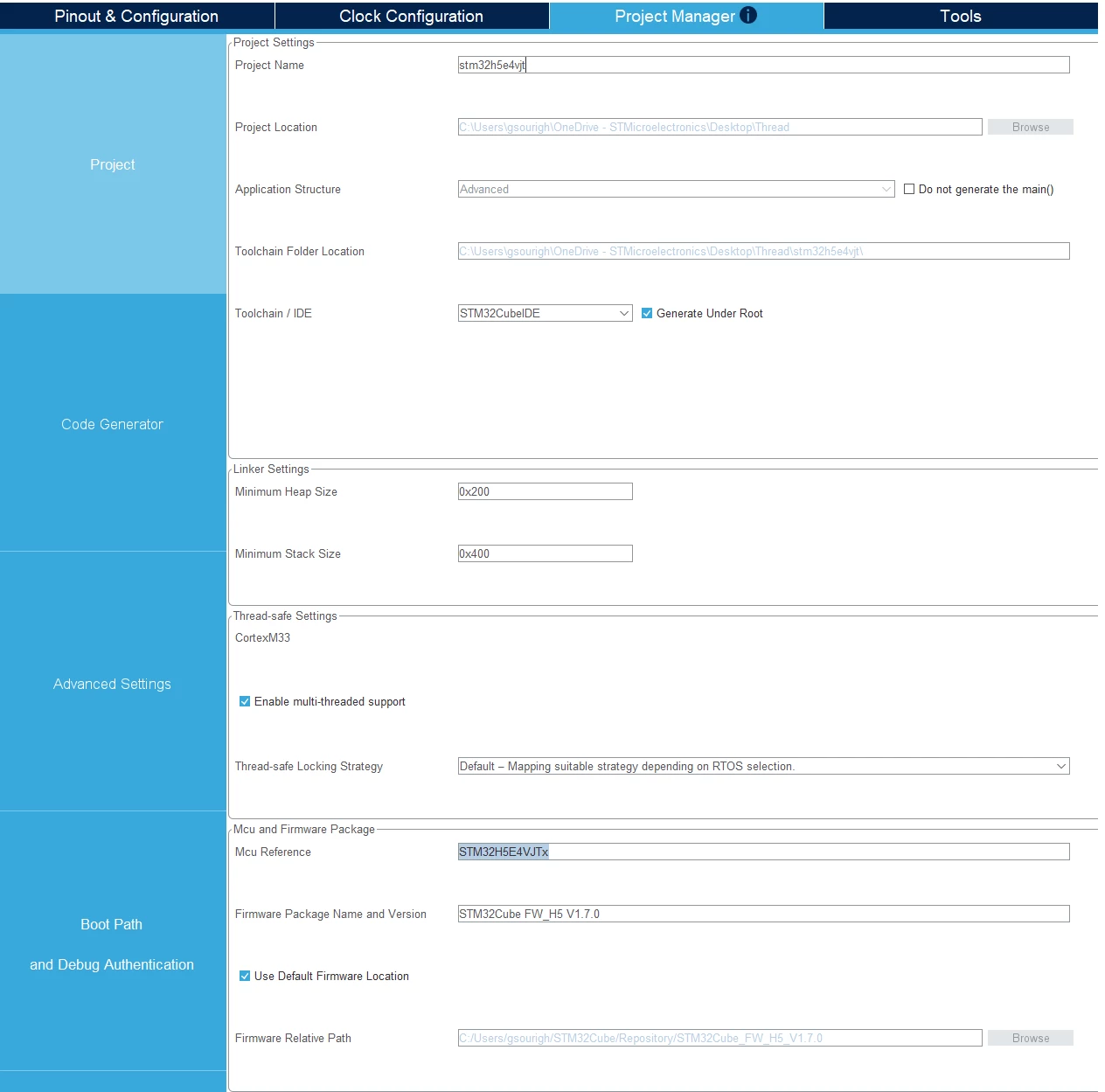

First make sure STM32CubeIDE is selected as the toolchain
After generating the code with STM32CubeMX , then open the project in STM32CubeIDE, right-click the project, and choose Convert to C++.

Hello ​@siva_28
STM32CubeMX mainly generates C code, but you can still use it very easily in a C++ project by generating the hardware initialization code with CubeMX, keeping those generated files unchanged as much as possible, and then adding your own .cpp and .hpp files for the application logic.
BR, Souhaib

Hello ​@siva_28

Thank You for the reply, Now I can use in cpp
