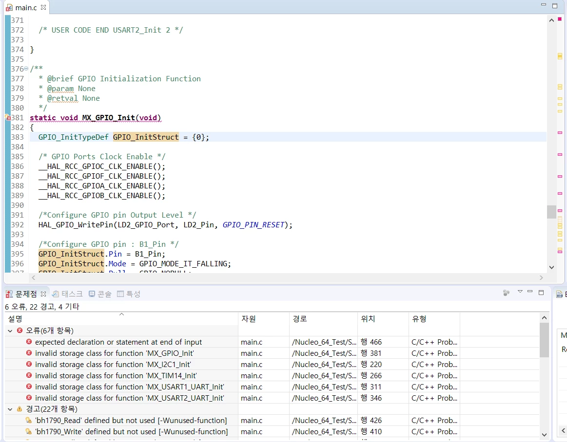

The name of the board I am using is NUCLEO-F091RC.
I am using TureStdio and want to use simple I2C communication.
But I get the error in places like MX_GPIO_Init (void).
The function is an automatically generated function so I don't know how to fix it.
Here is a list of errors:
expected declaration or statement at end of input
invalid storage class for function "MX_GPIO_Init"
invalid storage class for function "MX_I2C1_Init"
invalid storage class for function "MX_TIM14_Init"
invalid storage class for function "MX_USART1_UART_Init"
invalid storage class for function "MX_USART2_UART_Init"
I have attached my project.
Please help me.

The "expected declaration or statement at end of input" error means that there is an imbalance of curly braces { } somewhere in your code. The "invalid storage class ..." errors are only inherited from that.
In STM32CubeIDE use right-click > Source > Format to auto-indent your code. This might help spotting the error.
