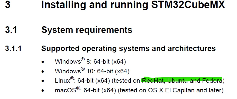

Hi @David Annett​ ,
According to CubeMX User Manual UM1718, the supported system for Linux are RedHat, Ubuntu and Fedora.
But we will try to setup the Linux Mint OS to reproduce what you are seeing.
Can you give us the Linux Mint version used by you ?
