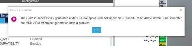

Code generation is failing when using STM32CubeMX 6.1.0 with a Keil uVision project.

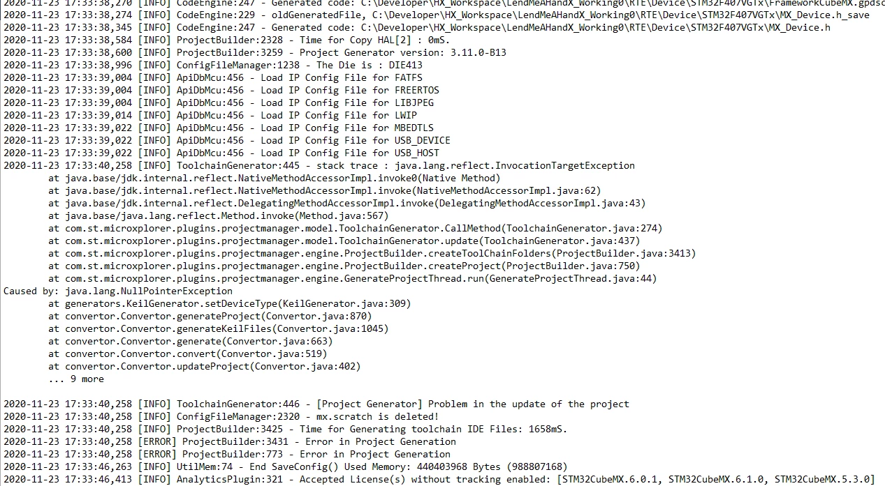

Code generation for a uVision project is working for STM32CubeMX Version 5.3.0, with any uVision version. After STM32CubeMX Version 5.3.0 code generation fails. The log file looks like it can't find the generator:

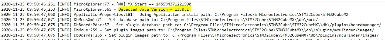

Hi TBrow.3,
Backing to your .log file you are using Java Version 13.0.1:
In fact The use of Java Runtime Environment (JRE) 64-bits is mandatory. JRE 32-bits is no more supported. The JRE minimal version is 1.8_45. The version 1.8_251 must not be used (known Java™ issue). Java™ 11 is supported. Java™ 7, Java™ 9, Java™ 10, Java™ 12 and upper are not supported.
For more details about CubeMX software requirements, please refer to the User Manual.
Uninstalling Java in your machine and installing a supported version will absolutely resolve your issue.

Hello TBrow.3,
Can you please indicate what version of Java are you using ?
It will be more helpful that you attach the .log file in order to detect the problem.

Hi Khouloud,
I've attached the log file from STM32CubeMX version 6.1.0
I was originally using this Java version: jre1.8.0_271
After seeing someone else solve their issue using openJDK I switched to this:
openjdk version "11.0.9" 2020-10-20
OpenJDK Runtime Environment AdoptOpenJDK (build 11.0.9+11)
OpenJDK 64-Bit Server VM AdoptOpenJDK (build 11.0.9+11, mixed mode)
Regards,
Tal.
