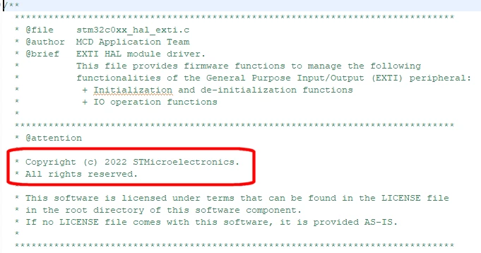

The file headers have a copyright year; eg,
I guess you could use that to narrow down a set of firmware pack versions to download, and then diff to see which one matches?

However, that just tells you what version(s) is/are installed on the development host system;  not what a given Project requires - which, I think, is what @aoltean was asking?
aolteanAuthor
February 21, 2024
Hi all, and thanks for the warm welcome.
That is right. I have an old project and I don't have this driver path (C:\Users\STM32Cube\Repository\STM32Cube_FW_L0_Vx.y.z\Drivers\STM32L0xx_HAL_Driver) available anymore.
Is there anywhere else I could get a hint?
