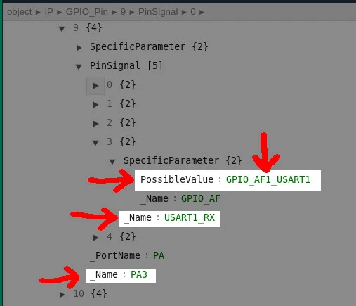

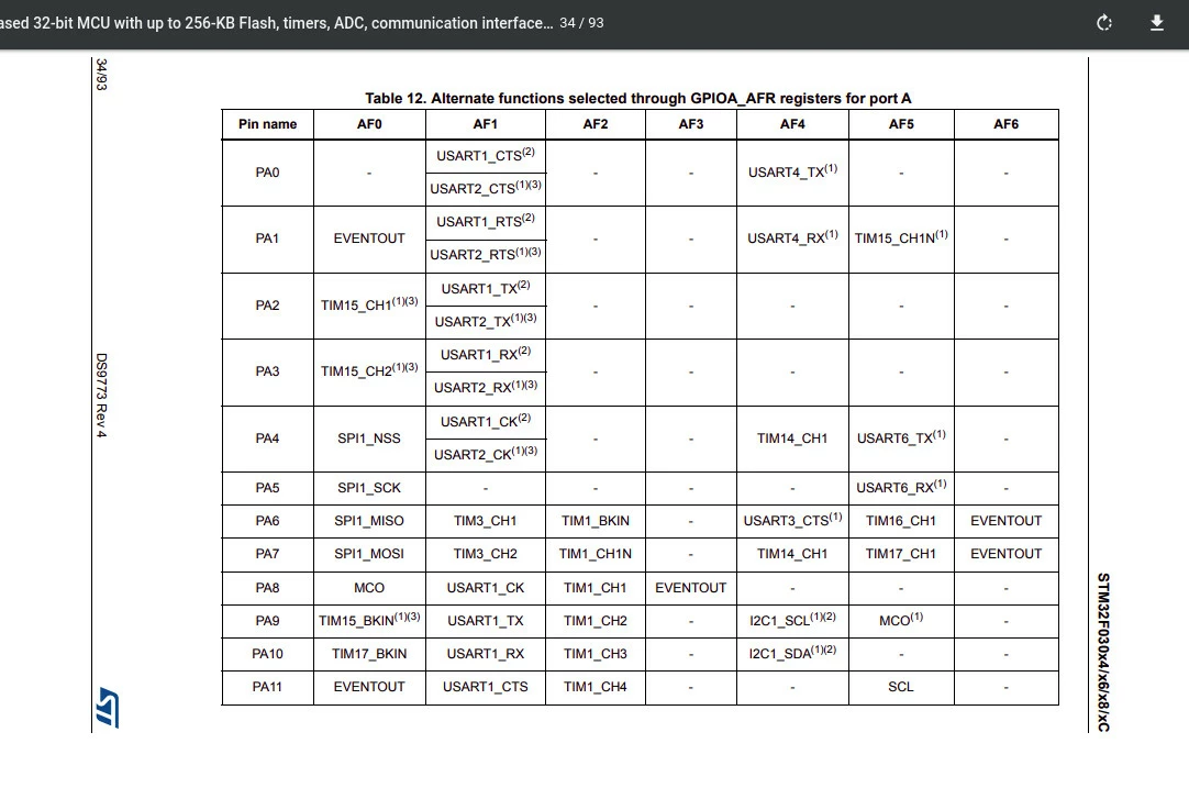

For example, in order to configure STM32F030F4Px's PA3 as USART1_RX, I need to set the relevant Alternate Function nibble to "1", as stated in datasheet.
What I could get from mcu/config/llConfig/GPIO-STM32F0xx_DefMapping.xml is that there are 3 "Item"s containing search word "usart1":
* An item contains "GPIO_AF0_USART1" string
* An item contains "GPIO_AF1_USART1" string
* An item contains "GPIO_AF7_USART1" string
How would I know which Item to parse?
In the file mcu/IP/GPIO-STM32F031_gpio_v1_0_Modes.xml, there is a structured data at: IP.GPIO_Pin.9 indicating the following:
This allows me to conclude that I need to set AF1 in order to configure PA3 as USART1_RX. However, this information is inside a file named *STM32F031*.xml where I'm interested in STM32F030F4Px.
How can I know which "*Modes.xml" file applies to STM32F030F4Px?
