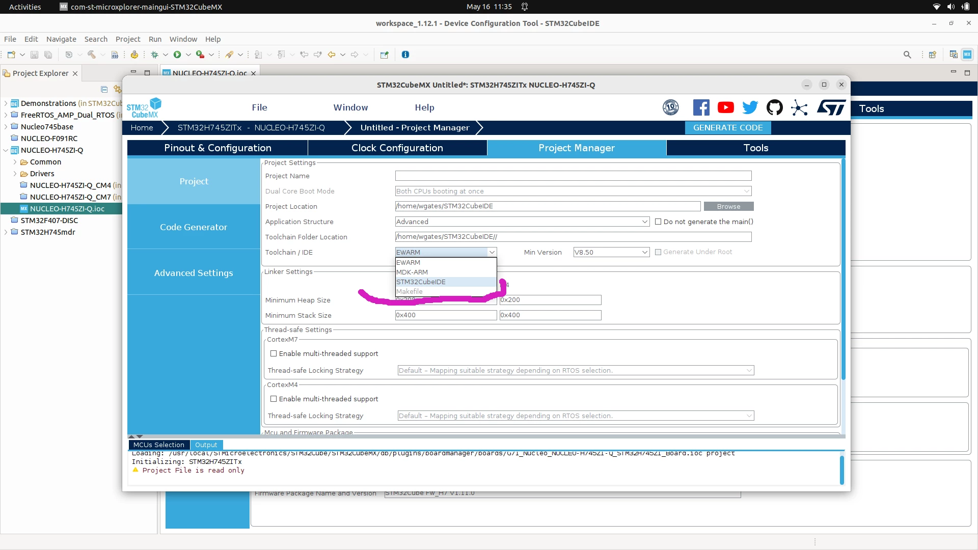

How to create/select a Make project for STM32H745x MCU using the STM32CubeIDE Version: 1.12.1?
  • May 16, 2023
  • 1981 views

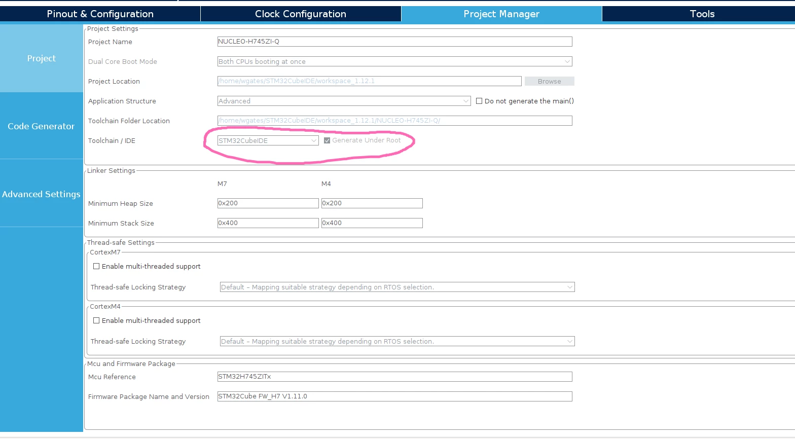

I am running STM32CubeIDE Version: 1.12.1 on Ubuntu 22.04. I am using a NUCLEO-H745ZI-Q board. Is it possible or reasonable to expect that I should be able to configure the Make tool chain using the STM32CubeIDE instead of the default STMCubeIDE tool chain? I also tried using STMCubeMX standalone but the Make options seem to be grayed out/inactive. I found AN5361 helpful for getting started but have not come across perhaps some deeper dive documents for Dual Core project setup.
Best answer by Herve PIERROT
Hi zirogravity ,
I got some rumors that for STM32CubeMX standalone, this makefile project type shall be activated for dual-core devices very soon. Traditionally, STM32CubeMX is updated end of June, beginning of July...
So, stay tune !!!

What I know, makefile option is avaiable only through CubeMx as standalone, not IDE
Dudo

May 17, 2023
Hi zirogravity ,
So, stay tune !!!
