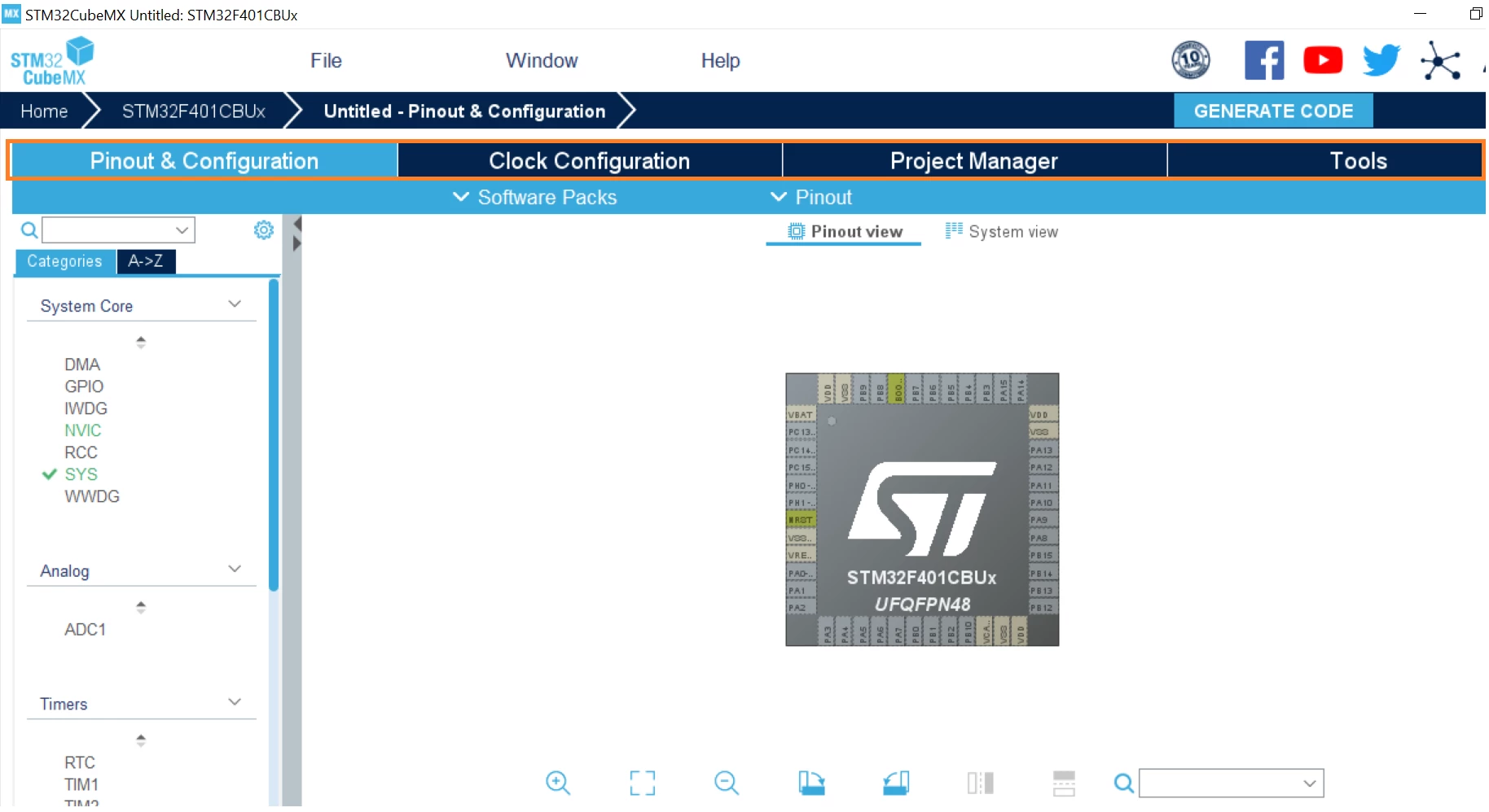

I make my own custom board using STM32 MCU(ex Stm32f4 disco) so I want to store it's gpio clock settings all configuration next time I want to use this board then all settings are initialise automatically how can I do this?

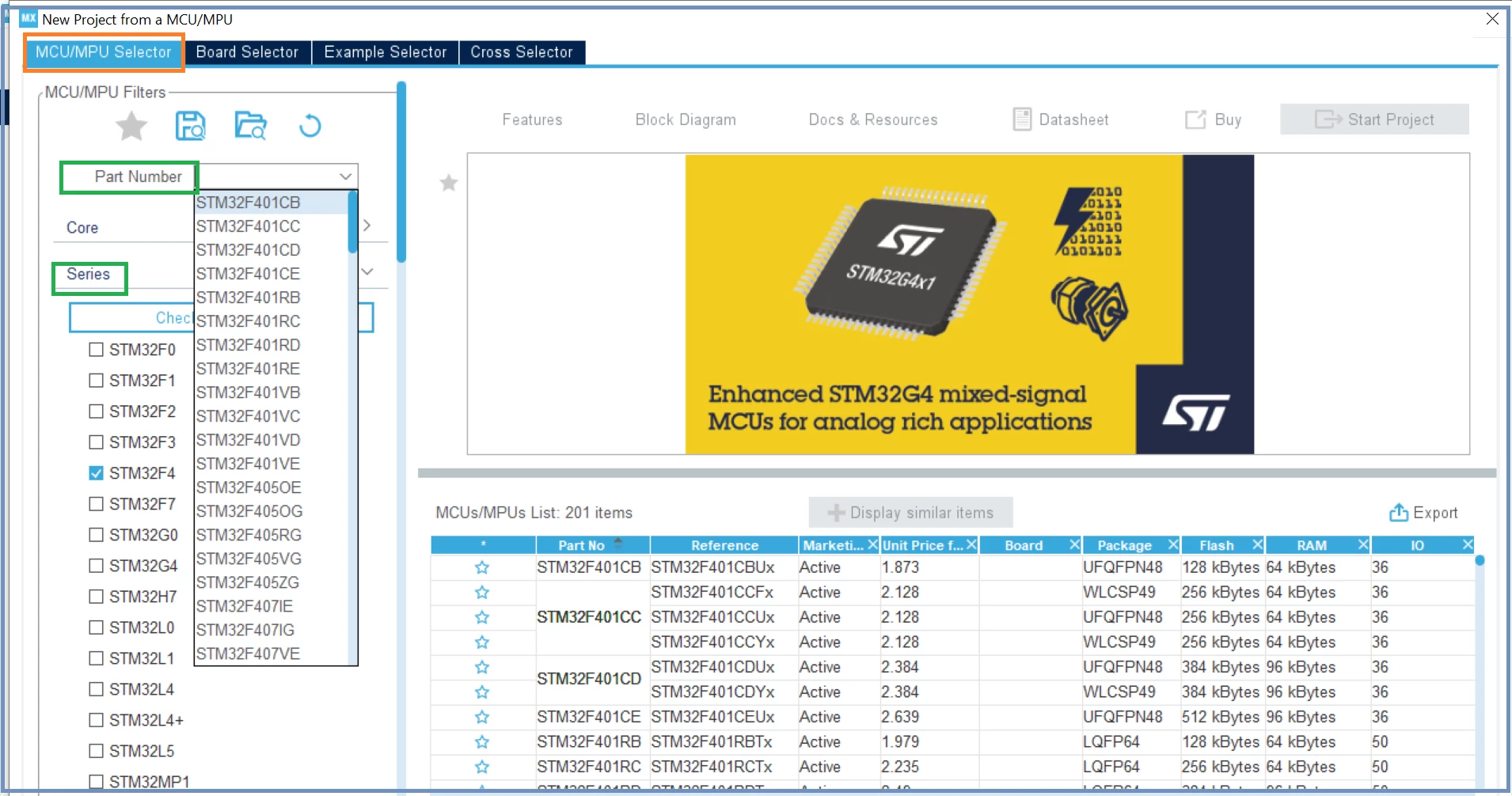

You can configure the STM32 chip through STM32CubeMX, first, you need to enter your exactly part number that will be used and press Start project:
0693W00000D2YM7QAN.pngYou can set/configure all the available peripherals, Clock and all the other options and parameters according to your need:

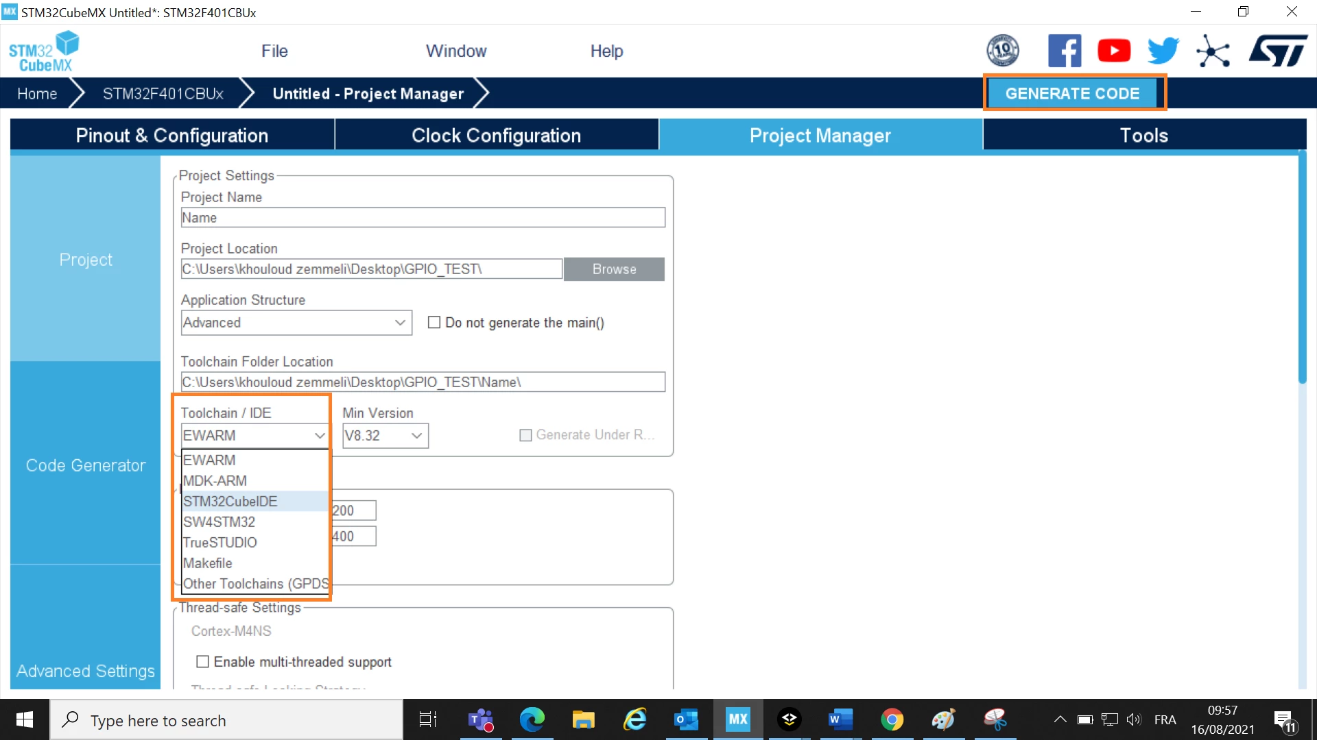

0693W00000D2YMlQAN.pngAnd then, you should choose the IDE to finally generate your configuration made in the previous step:
0693W00000D2YPkQAN.pngFor your own code, please add it in the preserved user sections.
