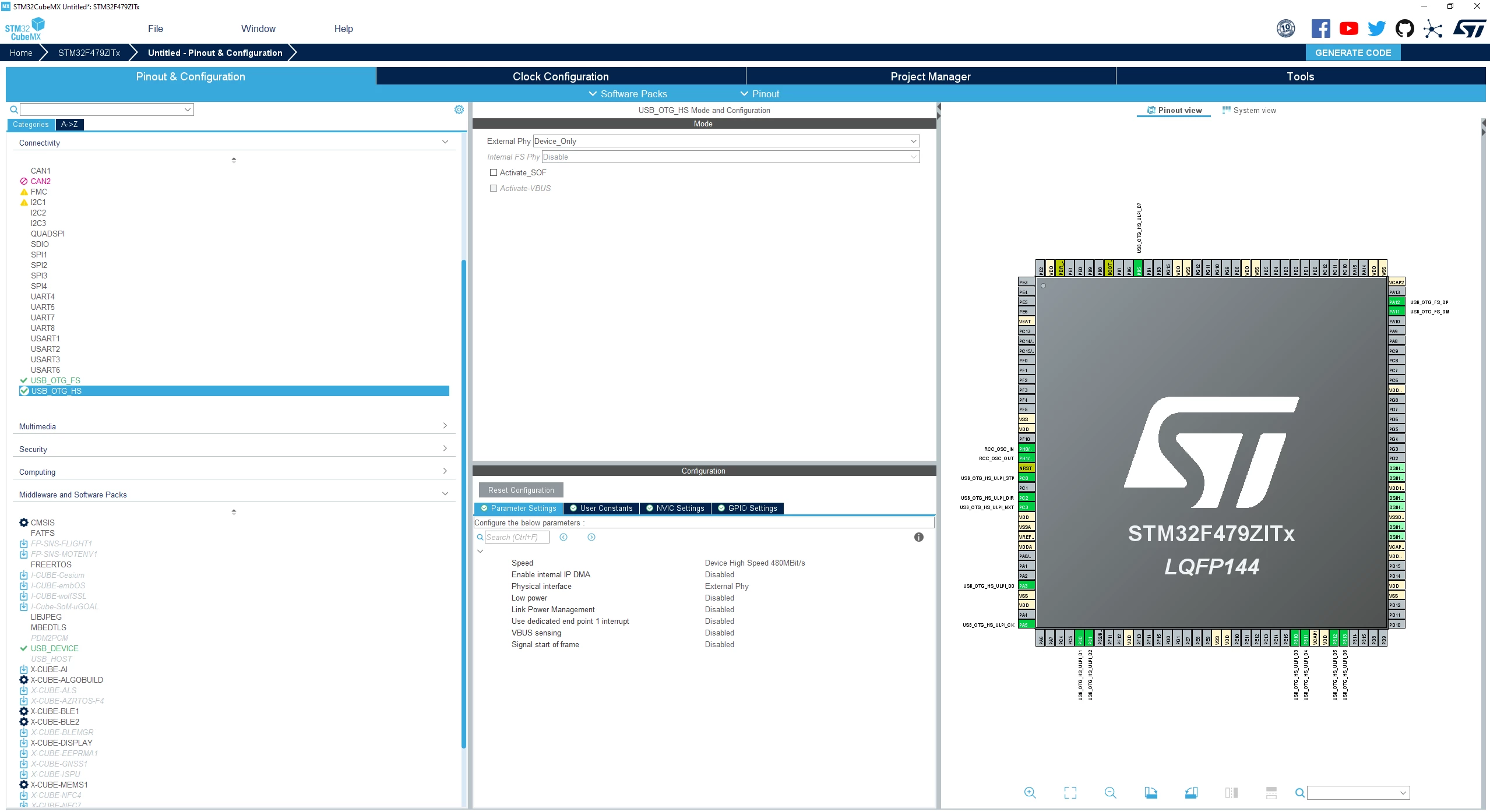

1- Select your target microcontroller model (e.g., STM32F479ZITx)
2- Enable the USB_OTG_FS and USB_OTG_HS by navigating to the "Connectivity" tab .

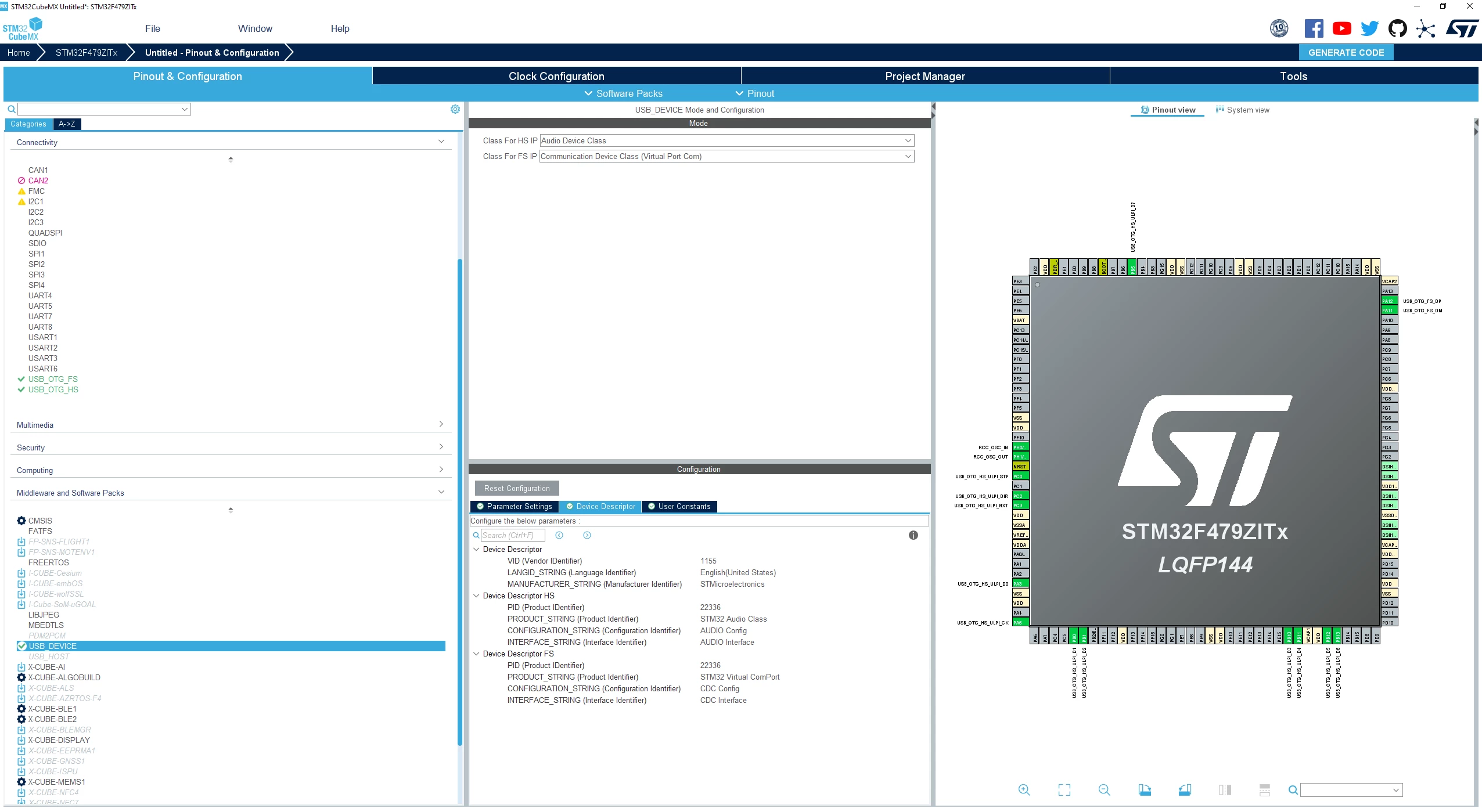

_legacyfs_online_stmicro_images_0693W00000dDTgsQAG.png3- In the "Class For FS IP" section, select "Communication Device Class (Virtual Port)" to enable CDC functionality.
In the "Class For HS IP" section, select "Audio Class" to enable UAC functionality.
_legacyfs_online_stmicro_images_0693W00000dDToRQAW.png4- Configure the other settings, such as endpoints, buffer sizes, and callbacks, as needed for your application.

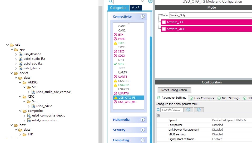

What you're asking for was available for the F407 in 2015, I have the code for doing this as you can see in this image.
STM seem to have dropped the ball on USB, it really seems like they are in a mess.  They've told me that they are focusing on USB for AzRTOS, and hope to have it working by Xmas, but like you, I'd prefer to have it working as it did back in 2015 but for the H7 in my case.

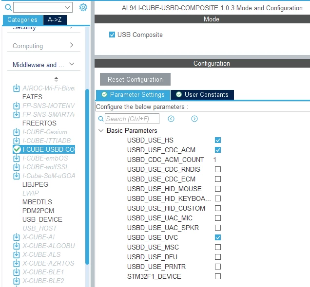

it is a shame that CubeMX does not support a combination of several device classes. After one day of searching examples i found a "software pack" for CubeMX:
alambe94/I-CUBE-USBD-Composite: Create STM32 USB Composite devices with ease. (github.com)
ST, please support this project and promote it, so we all can save lifetime!

Isn't the I-Cube composite plug-in fantastic!  I also passed it to STM's Paris support manager, Cedric, saying this was an example of what was needed, but the response was null, not interested.
IMHO I think ST staff have been coasting for years, taking it easy, their MCU products are not developed in-house, they buy in design parts, like the USB controller, and don't really have anyone expert in how to program it.
